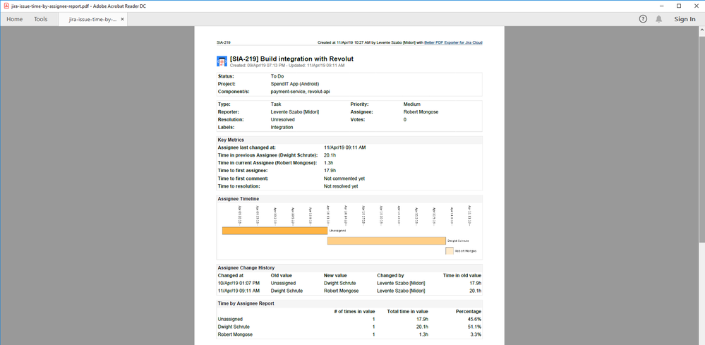

You can also try the default report in Better PDF Exporter for Jira which gives you a historical timeline of past assignees of a Jira issue. It's much simpler to create than advanced JQL queries or similar difficult workarounds.
Usage of the Jira assignee history report is summarized in this blog.
(Please note that Better PDF Exporter is a paid and supported app and I'm part of the team developing it.)
