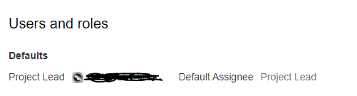

Hello ! I've been confronted to the same situation myself and finally found out the culprit: the project default assignee configuration is in User and roles.
To change it you need to click on "Edit defaults" on the top-right corner.
Dave Hattig
June 23, 2021
Yes thank you. That was it. I had Default assignee set to project lead instead of unassigned.
In cloud the path is Project Settings > Details > Default Assignee

This started happening with a new project and it drove me crazy looking everywhere in transitions, custom scripts, etc. Turned out to be:
Settings > Projects > click on project name e.g. ABC > displays Project Settings > Users and roles > Edit defaults > popup: Edit Project lead and Default Assignee for Project: ABC
Project Lead: YourLeadsJiraID
Default Assignee: dropdown defaulted to Project Lead > change to Unassigned > Update
Jira server 8.5.0
IMHO, it should default to unassigned to begin with to avoid just this problem.
