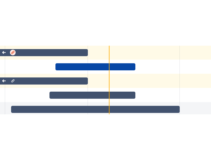

Ludvig Lindström
March 8, 2022
@Ravi Sagar _Sparxsys_
I've created a Plan with the Epics in my project and dependencies to epics to other project are shown as a symbol (see picture). But how can I make the epics from other projects visible in the plan?
