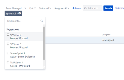

I want to set filters in my project for completed epics in the current sprint, but there is an error occurs saying that filter Sprint is not available. why this might happen?image.png

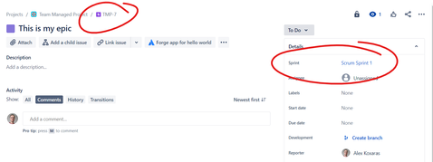

When I try to reproduce your issue, I've found out that in a TMP, the sprint field was missing from the screen. The result in the basic search I wasn't able to choose Sprint field. As soon as I add it within Epic issue screen, I was able to choose it from the advanced search.
Can you please check if you have Sprint field inside the epic issue type?
Alex
Vera Kim
August 1, 2021
Thank you Alex!
You were right, as soon as I added sprint field in the epic issue type, all worked
