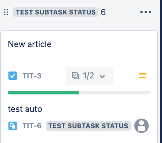

Trudy P Claspill
June 12, 2023
Adding to this...
If you are working with a Work Management project and you do succeed in setting up a separate workflow for Subtasks, be aware that the Subtasks will not display in a separate column from their parent task. The parent task and the subtasks can have different statuses, but the subtasks will always appear as a group under their parent task even when their statuses are different.

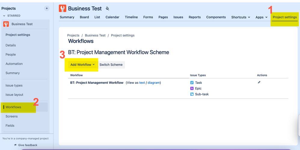

Jack Brickey
June 14, 2023

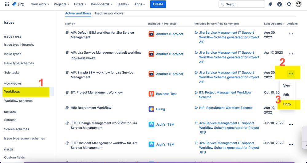

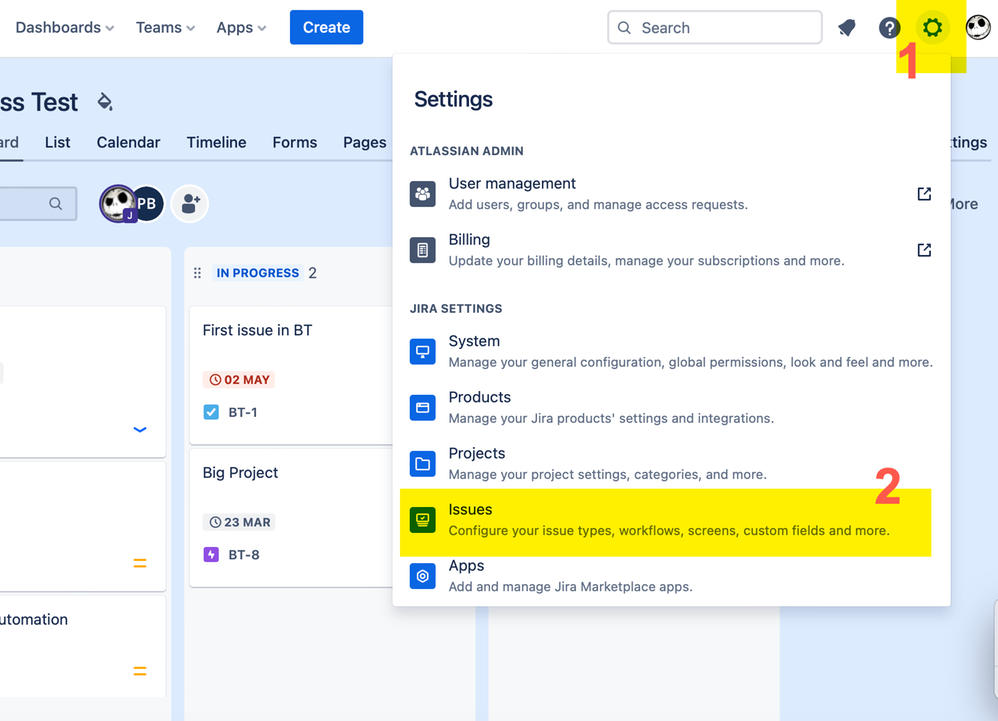

You basically need to create a new workflow and associate that new workflow to your project and specifically to the subtask issue types. Below is an example of how I would do that. Note, I am assuming that the workflow you want for your subtasks is very similar to that love the existing workflow. Hence I am using the copy existing workflow method. You can opt to simply create a new workflow from scratch.
1) Create new workflow (I used copy in my image example)
Find your current workflow and click on ellipses.
2) Add new workflow to your project's workflows. Choose Add existing after clicking on Add Workflow, find and add it then follow screen prompts to associate to subtask.
Please do be aware of what Trudy mentions above regarding how the subtasks will be displayed on the JWM board. The results may not be what you ultimately desire. For that reason you may wish to try this out on a test project first. Of course you can always undo the above.

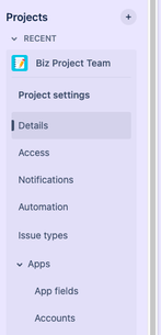

Shaked Shavitt
June 18, 2023
Thanks!

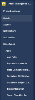

My project settings looks different than yours, what should I do?

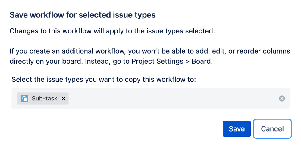

Jack Brickey
June 19, 2023
You are using a Team Managed Project. Moreover, this is not a Jira Work Management project which is the collection associated with this post. You might find the following article useful in understanding workflows in TMP - set-up-a-workflow-in-a-team-managed-software-project .
basically you should do the following...
  1. click on Issuetypes
  2. select sub-tasks
  3. click on edit workflow
  4. change your workflow
  5. Click on update workflow and be sure to remove any issuetypes other than subtask

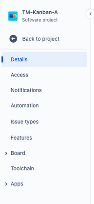

Trudy P Claspill
June 19, 2023
@Jack Brickey
The OP is working with a Team Managed Work Management project. If it was a Software project it would say "Software project" below the project name.
Example of Project Settings from a Team Managed Work Management project.

Example of Project Settings from a Team Managed Software project.
