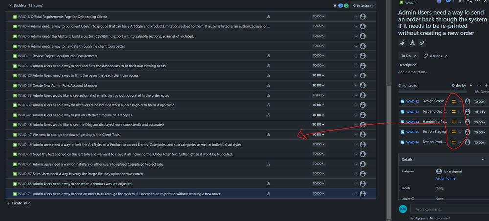

So, I saw a question about seeing priorities on the storyboard, etc., but I just want to know how to set a priority for an issue I have in the backlog. As of right now, I am only able to set priorities for the child issues within the issues on the backlog and that doesn't seem to make sense to me.
Forgive me if I'm missing some rules of Project Management here; I'm not trained in it or Jira, I'm just trying to figure out a way to make it work.
For context;
I work with an external dev team, and I would like to create the list of backlog items and set a priority on them at the top level, so that the devs can effectively plan the sprint without me being present. I work as the UX Designer and it makes more sense to do it this way.
Is there some process or feature I'm missing here? Ideally I could just set the priority and move forward, but open-minded to other suggestions.

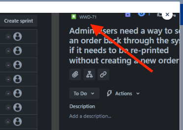

If you click on the issue key in the left panel for WWD-71...
...then WWD-71 should display in a new browser tab or pop-up. You should then be able to edit the fields of WWD-71 if you have the right permissions and the field is present on the screen.

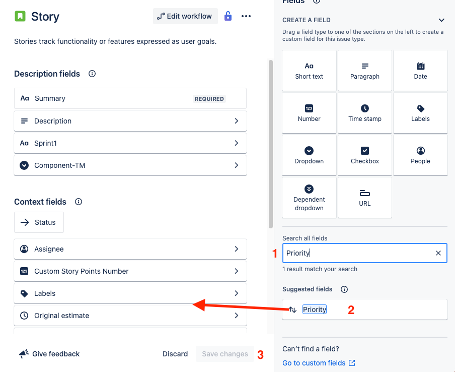

If you still don't see the Priority field, then it may not have been added to the screen for that type of issue. In that case, if you have enough permissions, you would need to click on the Configure option (shown in the screen above), search for the Priority field in the panel on the right (1), and drag-and-drop it into the center section to add it to the screen(2), and then save your changes (3).
