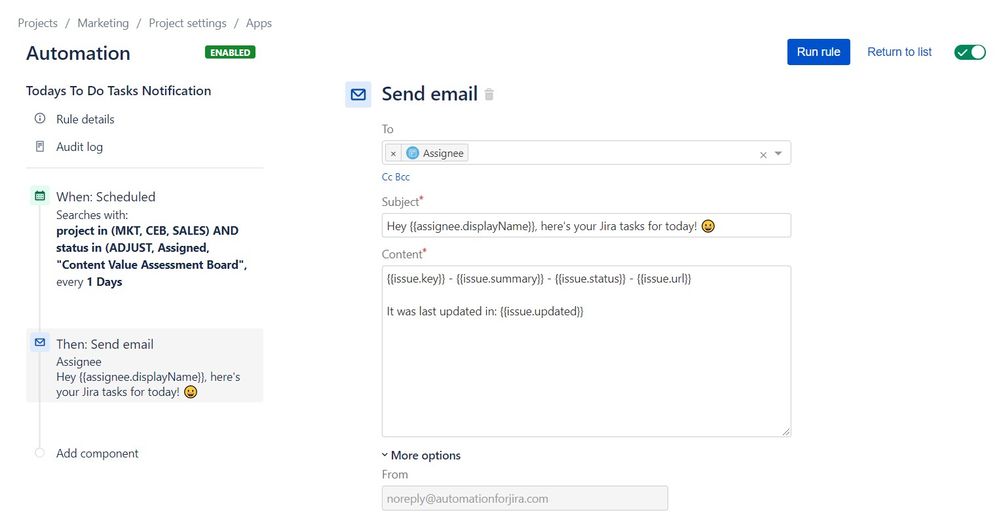

I set up an automation to notify the daily tasks, but only goes out by the end of the day, how to change this?

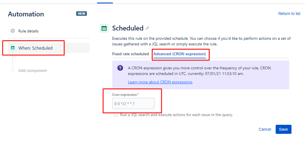

@Pedro Hernandes using cron job you can do this. Please find the link for adding cron expression.

You can easily do this, as you are using the scheduled as the trigger you have an option to set the timeline to send the notification. Please find the document here, you can find the info under the Schedule section. The doc helps you with the link to define the cron job also.
https://support.atlassian.com/jira-software-cloud/docs/automation-triggers/

if you set up your automation as “scheduled” do the trigger then you can use Cron language to specify the when. There is a link in the automation that will assist if needed.
