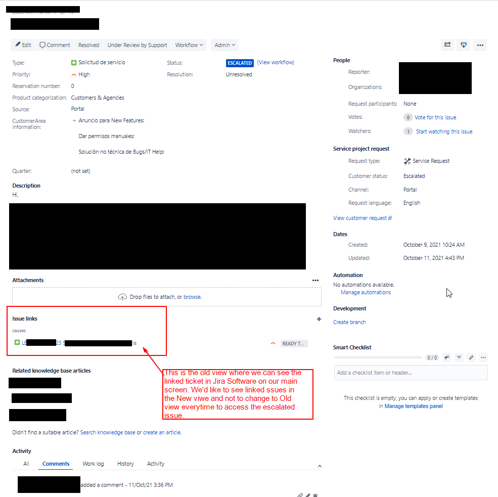

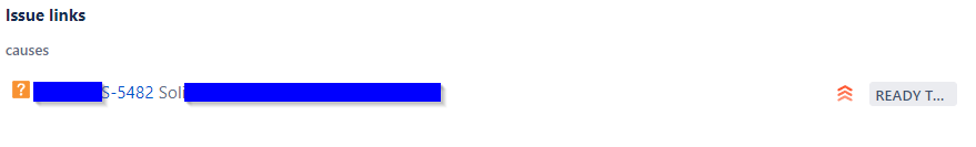

(Following example of what we'd like to see in the new view that is visible in the old view:
220221_Issue link old view Jira.png)

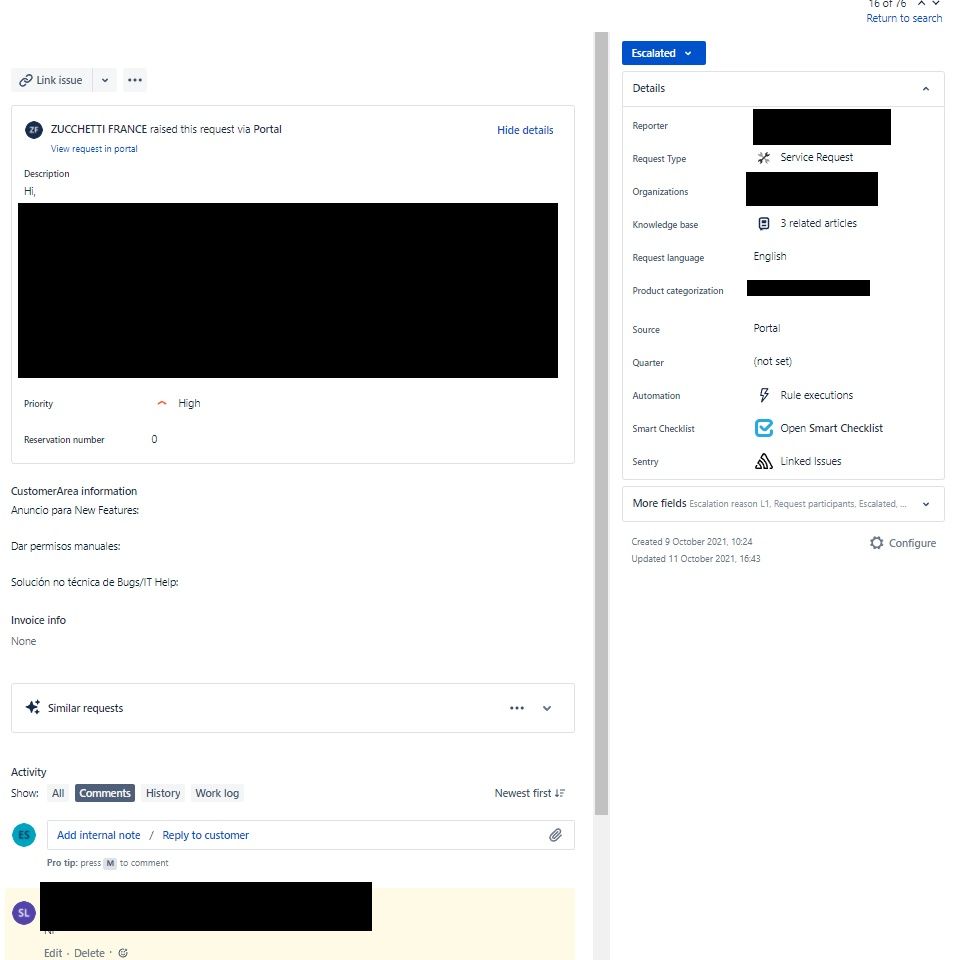

I'm attaching two screenshots from Jira NEW view where you cannot see the linked issue and the OLD view where is displayed on the main screen. I hope you can give us a hand on how to configure it so we can see the linked issues in the New View. Thanks again!!JIRA NEW VIEW_no issue link.jpgJIRA OLD VIEW with linked issue.png

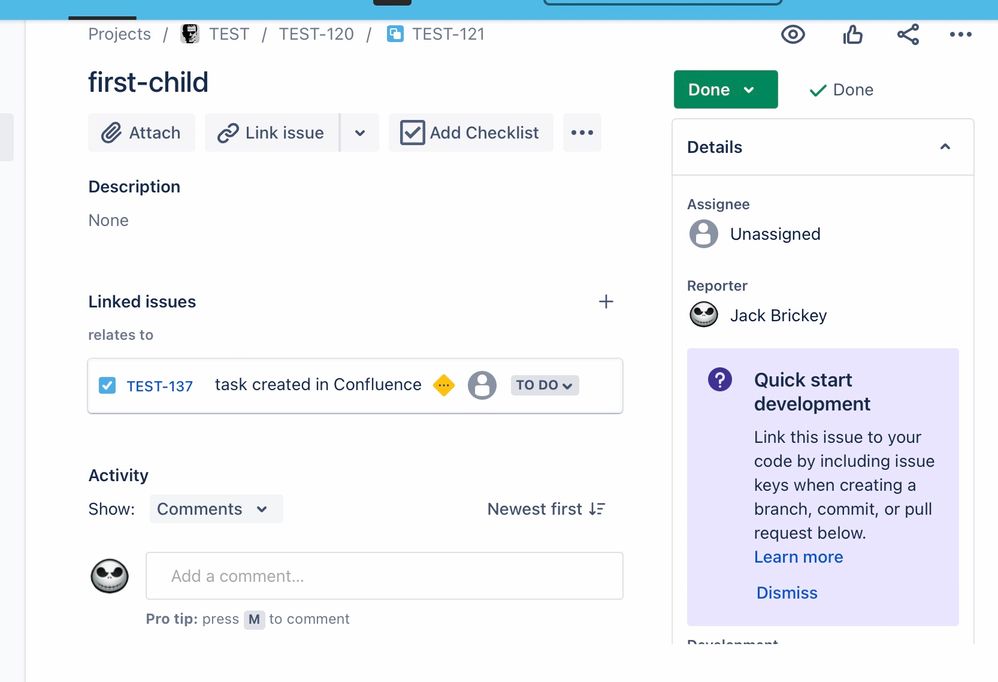

Are these views of the very same issue? In your first image I see the link issue icon or button. Could you please click that button and link an issue and see if it then appears? Here is what I see below. Keep in mind Linked issues will not appear until there is a linked issue.

Yes, it's exactly the same issue both in New and Old view .
When I click link issue, it gives me the possibility to link another issue, but I cannot see the issues already linked. These are all the possibilities displayed after clicking "link Issue" and surrounding fields: (I'm showing a ticked that already has a  linked issue but is not displayed unless I go to the old view)
(Just by clicking Link Issue nothing happens, we only get an info message, arrow shows link Conflunce or weblink, and 3 dots is just to add apps. )
We can't seem to find a way to see the already linked issues in the New view mode, with the Old view mode it's displayes on the main screen .
