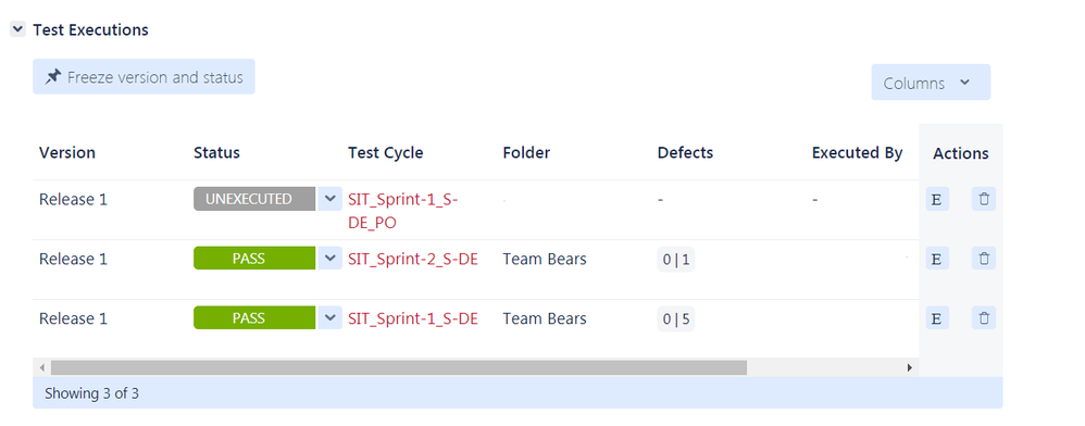

Within the testcase, the test execution are shown as follows:Screenshot Test Case Execution.PNG

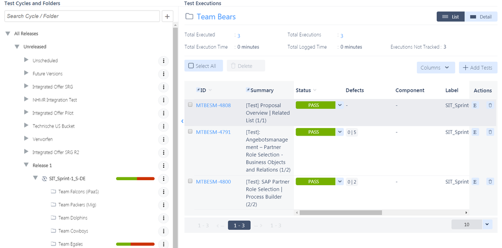

And this is how our test cycle execution looks like:

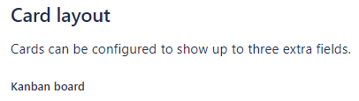

 information about the testcase execution status. is this shown in a field?
if so then you can choose to show that field directly on the card,
go to board -> configure -> card layout
