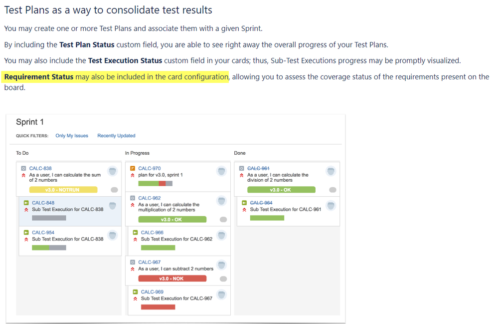

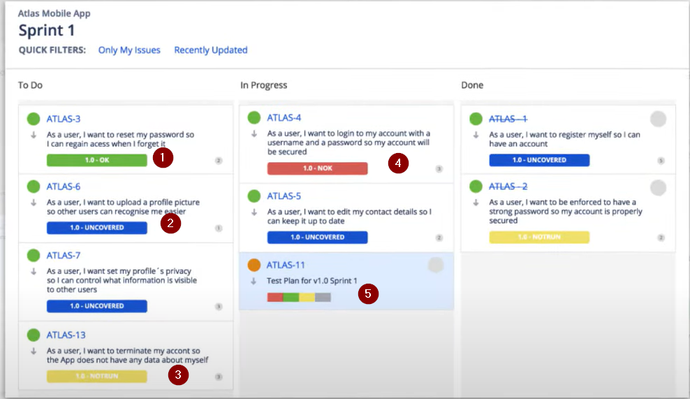

We are unable to see XRay status for Stories and Test Plans progress in our JIRA project board.
We are using Kanban Board but even trying with a Scrum Board, I am unable to see those fields shown on the board at a 1st glance (indicated with the numbers in a red bubble) as they are displayed in the screenshot below:Xray Test Management App - Quick demo - YouTube.pngThis picture was taken from the Xray Test Management App - Quick demo, which it is published in the Atlassian Marketplace.
