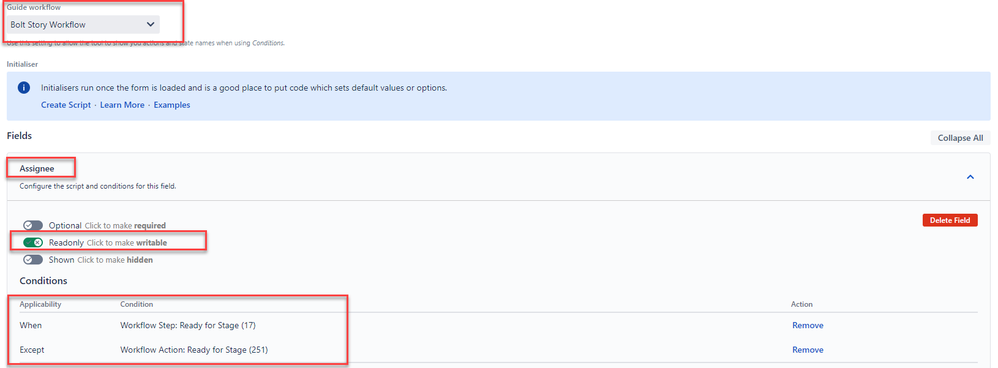

Just create a new behavior and map it to the appropriate project/issue type.  From this point, you have two options:
1. Add in the Assignee field and set the Guide Workflow to the workflow name for the issue type.
Note that if you have multiple issue types where you want to do this that are not using the same workflow, you'll have to create a different behavior for each workflow if you use this option.
Set the option that the field is read-only and then add a condition that the Workflow Step is Status B. You will also need to add an exception condition so that it doesn't apply when you are executing a Workflow Action that matches the transition from Status A to Status B.

Matt Parks
February 16, 2024
Here's a screenshot of what option 1 could look like.Assignee Read Only Behavior.png
