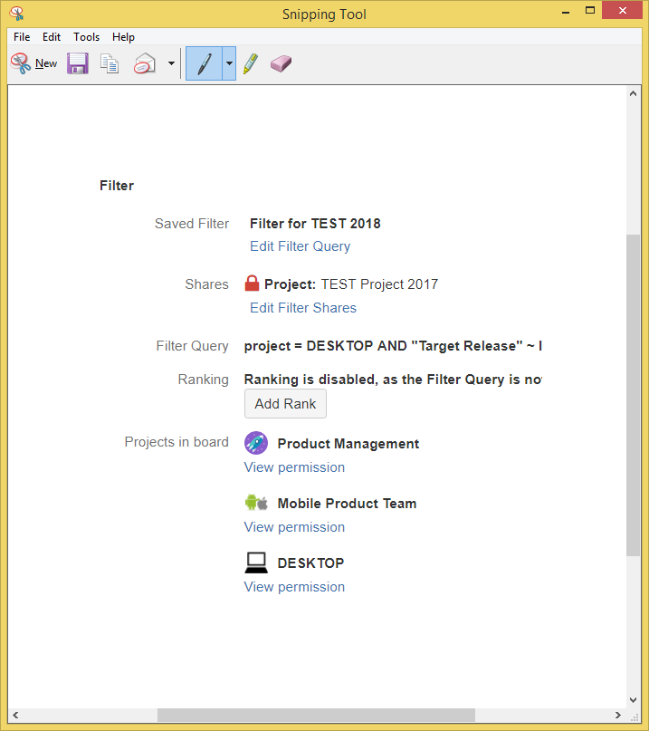

One of the users have created a kanban board and it shows 3 projects under configuration/projets in board section even though the filter query states only one project. How can I remove the two projects from this new board?
Thank you.
Elif
Jobin Kuruvilla [Adaptavist]
January 10, 2018
What is your filter query? Does it accidentally include issues from the other project? Probably via an "OR" clause?
Elif Alverson
January 10, 2018
Filter query is  project = DES AND "Target Release" ~ A_win_1.0.0 OR "Target Release" ~ A_mac_1.0.0 ORDER BY cf[11200] ASC
These target releases are not being used by any other projects but DES. So, I am confused about these other projects are showing up on the configuration of this board?

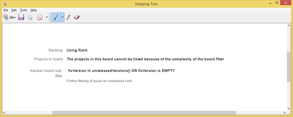

@Jack Brickey , we use server and if you go to board/configure/general you will see the " projects in board ". See the attachment below .
I created another one for a different project to see if I will have the same issue. Here is what I am getting now.
Projects in board : The projects in this board cannot be listed because of the complexity of the board filter
 Same exact filter query with a different project name:
Filter Query : project = "TEST Project 2017" AND "Target Release" ~ A_win_1.3.0 OR "Target Release" ~ A_mac_1.3.0 ORDER BY cf[11200] ASC

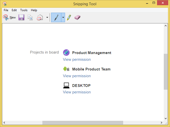

I have changed the project to DES and same issue occurs. I see 3 projects. So deleting and recreating the board does not help.
Elif Alverson
January 10, 2018
When I stop using " OR " clause for the filter query, it looks the way it should. Projects in board only shows the project in filter not the other ones which use the " target release " custom field.
