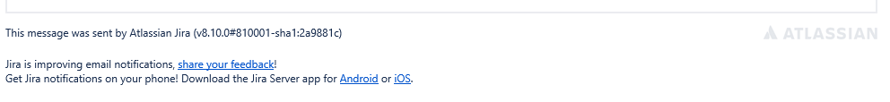

OK I did that but still seeing footer info after that change.
Any other place I can change it?

Nope, that's the file generating it.  Did you restart Jira after the change?  And what do you now get in the footer?  (After restarting)
eburnett
August 5, 2020
I stopped jira,
made change to D:\Program Files\Atlassian\JIRA\atlassian-jira\WEB-INF\classes\templates\email\text\includes\footer.vm

started Jira back up
eburnett
August 6, 2020
I guess that this footer is in the html response.  so what do I remove from this file?

Nic Brough -Adaptavist-
August 6, 2020
So, I have messed up here.  I apologise for wasting so much of your time here.
I completely forgot all the emails are produced in pairs - text and html.  You mentioned footer.vm for the text ones, and I think I got the answers for those right, but then ran with just that one half of them.
But I completely forgot the html adjunct, which explains why people saw no change - we'd only amended the plain text ones and most people see the (default) html versions.
So, for the html emails, the answer is similar - comment out, or remove, any line you do not want to go into the email.
  1. For html, that means getting rid of the content and structure commands.  I'd be brutal here, but one step at a time (don't do all of this, do one section, test it and then move to the next)
  2. Comment out <span id="footer-build-information"> and every single line within it.  Get the section out that starts with <span id="footer-build-information">
  3. Next hit "extraFooterContent"
  4. Finally, the "#parse("templates/email/html/includes/emailconstants.vm")" block, but I don't think you will need to hide that.
