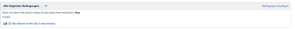

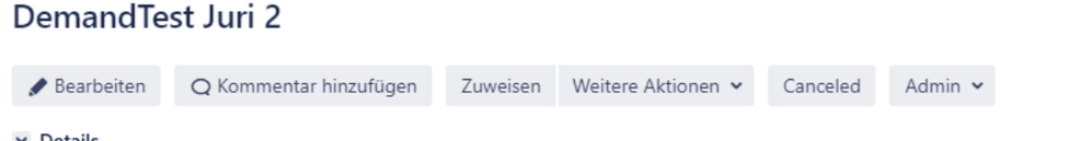

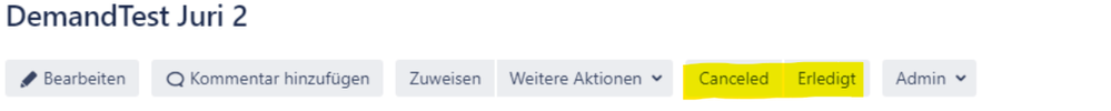

In my topic, I want to configure the system so that it’s not possible to set an open task to the status "Done" or "Canceled" if there are still open subtasks.
I know that under the "Triggers" section, you can set the transition to "All subtasks must be done," but here’s the actual problem:
I don’t want the "Done" button to disappear. Instead, I want it to remain visible, and when I click it, there should be a message like "Check open subtasks," for example.
How can I set this up? Does anyone have an idea?

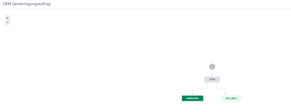

Hei @Tuncay Senturk _Snapbytes_ Sorry for bothering you again, but how do I rewrite the script so that not only the sub-task is checked, but also the task "Genehmigungsaufgabe"?
MidnightExe
December 18, 2024
seems liked It worked now with this one:
