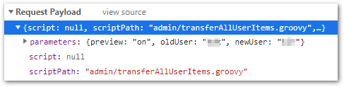

The only way to pass parameters to such a script is to use the "dynamic form" feature
Looking at browser network call when you hit run, you can see that the payload includes 2 elements. A "parameters" json and the script string or scriptPath.
2021-06-15 20_08_38-DevTools - projects-dev.qad.com_plugins_servlet_scriptrunner_admin_console.png
I haven't tried with curl, but you can try something like this

Ricardo Martinez
June 23, 2021
Hi;
Thanks, what you said gave me the clue on how to get the curl call with the correct parameters.
The call is similar to what you were saying.
curl 'https://[jira]/rest/scriptrunner/latest/user/exec/' \
-H 'Accept: application/json' \
-H 'X-Atlassian-token: no-check' \
-H 'Content-Type: application/json' \
-u user:pswd \
--data-raw '{"script":null,"scriptPath":"testscript.groovy","parameters":{"valueToAdd":"10"}}'
That should do the trick.
