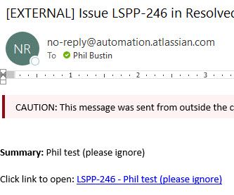

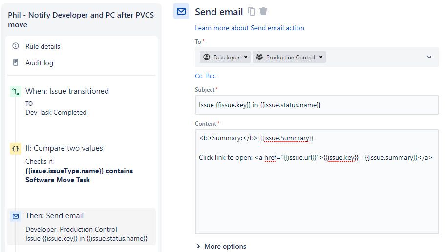

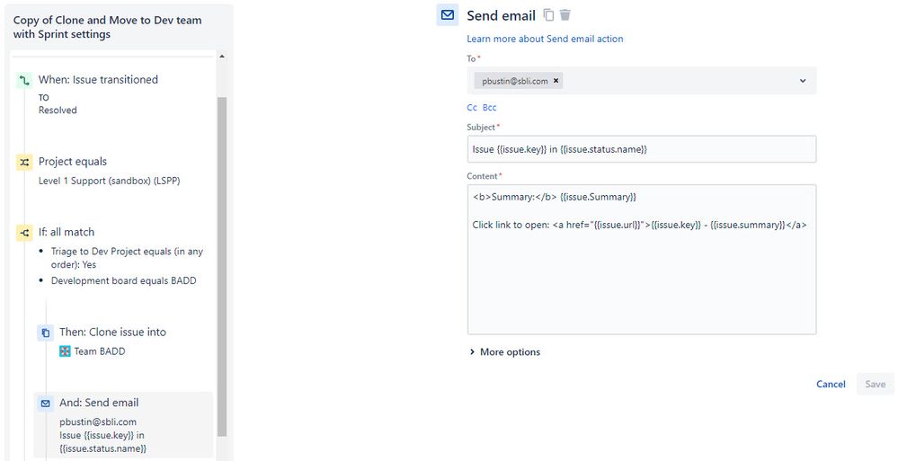

It was the end of the workday, so I deferred uploading a screenshot of the rule until now:
Automation
Email received, containing the JSM issue key instead of the just-created Jira Software issue key
Trudy P Claspill
May 3, 2023
I don't see the connection between the rule you posted and the scenario you described about an automation that runs against a JSM project and uses the Clone Issue action to make copies of the JSM issue in other projects.
For the rule you posted the only issue within the context of the rule is the issue that triggered it, which is an issue that had its status changed Therefore the issue information available through the {{issue}} smart value will be the information of the trigger issue.

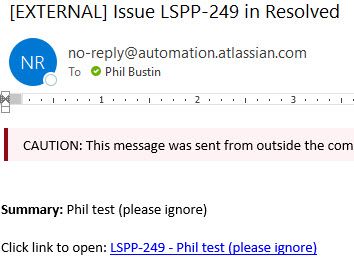

I apologize.  Here are the current automation and resulting email.  BTW, I came to the conclusion that although it may be possible with branching to send the desired email in this automation, what would likely work is a new automation with an issue created trigger.
Automation
Email received
Trudy P Claspill
May 4, 2023
In the context of the rule you have posted {{issue}} is still referencing the issue that triggered the rule. {{issue}} will change context when you go into a branch.
If you want to reference an issue created within a rule, you can use the {{createdIssue}} smart value to reference the last issue created in the rule. You may want to add a Re-Fetch Issue action before attempting to use the {{createdIssue}} smart value to ensure your rule has current data.

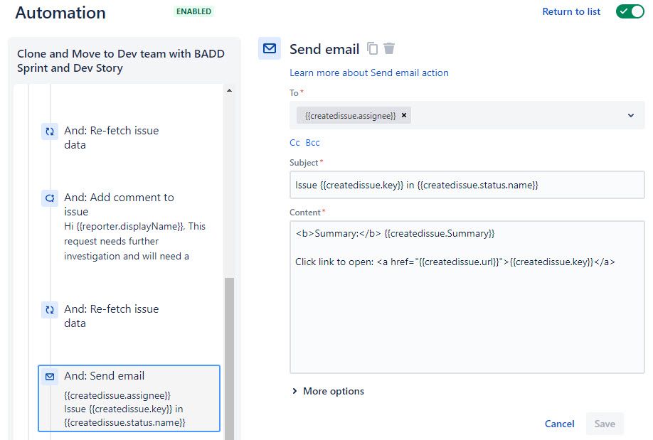

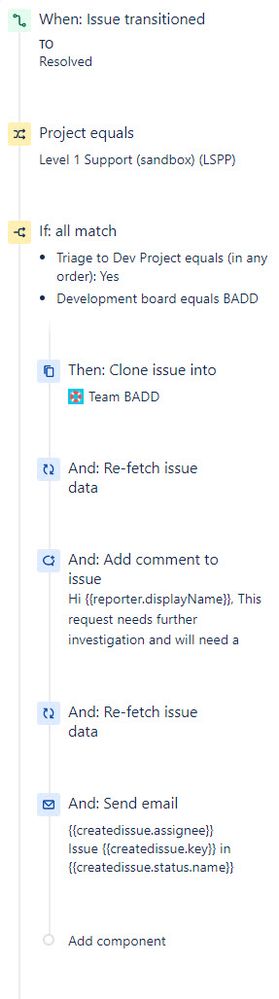

Phil Bustin
May 5, 2023
Still working on this, but it would appear that even though the assignee was set by me to myself in the Move to Dev Team transition screen, assignee is apparently unknown to the email component, because it causes the error below.  Assignee is not among the fields modified in the clone detail.
Automation
Automation email detail
Automation email error
Trudy P Claspill
May 5, 2023

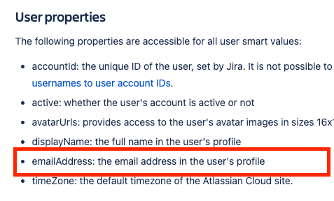

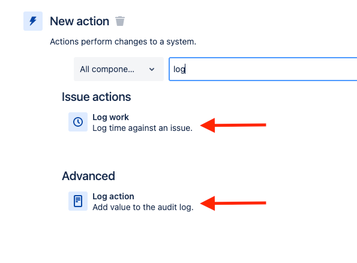

Use a Log action to print the {{createdIssue.assignee}} value to the Audit log to see what the actual value is. Typically the assignee attribute returns the user's unique account ID, not their email address. To get their associated email address you need to reference another attribute. Refer to this documentation.
Jira Smart Values - Users

I got the same empty assignee error using {{createdissue.assignee.displayName}}, that I found in the Jira Smart Values - Users link you provided.
Trudy P Claspill
May 5, 2023
You should have two actions that start with the word "Log" - "Log" and "Log Work"
You received the error because the smart value you provided (displayName) is not populated with an email address. For the To field of the Send Email action you need to be providing an email address. Use the emailAddress attribute.
