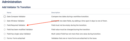

Jeroen Poismans
April 26, 2023
Hi John!
You can do this with Validators:
  • Identify the workflow associated with your project and issue type
  • Edit the workflow
  • Open the Create  transition
  • Add a Validator
  • You can add multiple fields in the same Validator
Hope this helps!
Jeroen

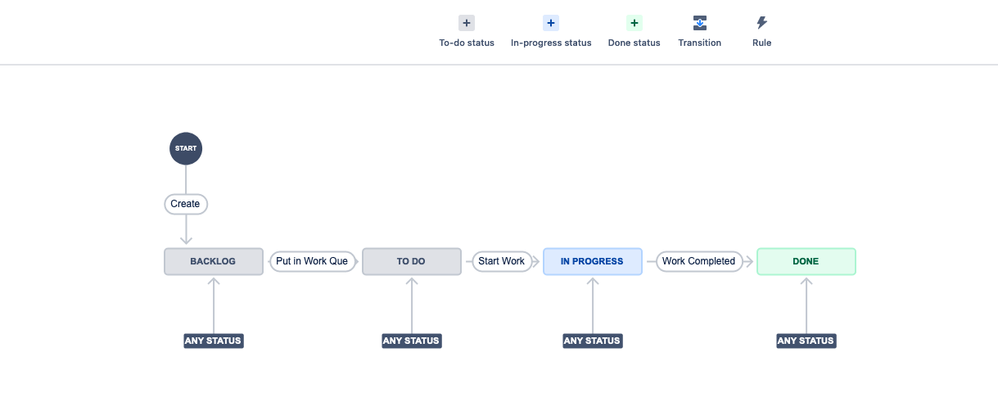

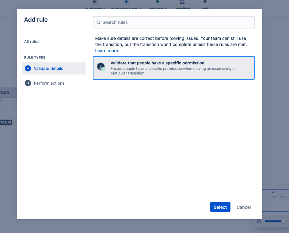

Alex John
April 27, 2023
It looks like all I can validate in JWM for a transition between "Start" and a To Do titled "Backlog" is to make sure that whomever is making that transition has permissions to do so, not that fields are being required:
Screen Shot 2023-04-27 at 4.21.09 PM.pngScreen Shot 2023-04-27 at 4.22.15 PM.pngScreen Shot 2023-04-27 at 4.22.45 PM.png
Jeroen Poismans
April 27, 2023
Oh, I see, is this by any chance a Team-managed project you're working in? Because that will certainly limit the possibilities in the validator section.
Jeroen
Alex John
April 27, 2023
That did it!  If I wanted to create a Company-Managed project and use all of my new base settings as a template, would I then turn it into a Team-Managed (assuming that I didn't want people to mess with the settings too much)?
