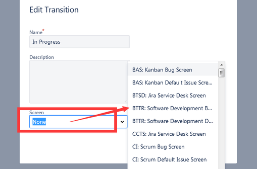

You can refer to the following steps to configure this transition
1. Create an screen with the fields you need to display
2. Modify the workflow to manage this screen in the middle of 'in progress' to the 'testing' status

Hi @sssssss,
As @Ollie Guan said create a screen with the field and add the screen to the Transition (to create a screen Go to issues--> screens--> Add screen and provide the name and description of the screen --> it will create a empty screen --> add the field to the screen )
To make a field mandatory while moving an issue to the Testing  status add a validator to the transition called "Field is required Validator (JMWE add-on)" and select the field which you want to make mandatory .
