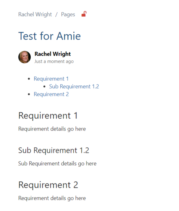

Hi again @Amie Fudge, I thought of something else:
You could use Confluence's "Table of Confluence" macro to get a reference link to each section of the page. In the example below, the link to the "Requirement 1" header is unique. It's in the format:
YOUR-JIRA-URL/wiki/spaces/~rwright/pages/123456789/Test+for+Amie#TestforAmie-Requirement1
But, this breaks easily if anyone changes the header copy (ex: "Requirement 1") on the page. I still think the "one requirement per page" idea is much better.

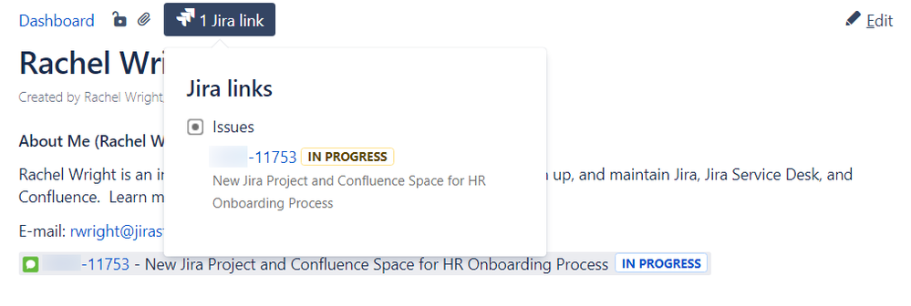

Is there a way to do the opposite? supposed you have a page for each requirement how do you link it to an issue?
What I am asking is , when i am creating an issue in jira is there a way to have a field or link to a confluence requirement from within jira? so i can search and see how may issues are linked to this requirement?
Hi @[deleted], it's easy to do this if your Jira and Confluence applications are connected via an "Application Link."
Here's an example of linking a Jira issue to it's related Confluence page.
In the Jira issue
Click More > Link and change the link type from "Jira Issue" to "Confluence Page." You'll find this option in the left sidebar of the linking overlay. The result adds the page in the "Issue Links' area with the other linked Jira issues.

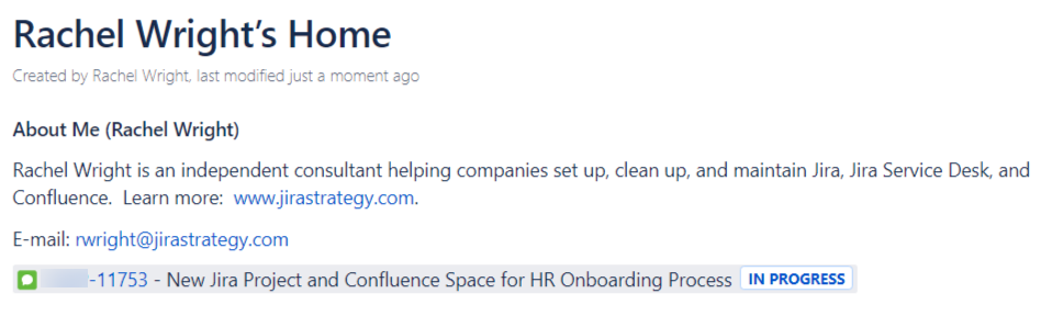

On the Confluence page
Simply paste a Jira issue's URL into any Confluence page! It will create a dynamic link to the issue and pull in the icon, key, summary, and status. You and also insert a Jira issue macro for single or multiple issues.
For your search question
Any Jira issues linking to the specific Confluence requirement page are totaled and listed at the top of the page.
