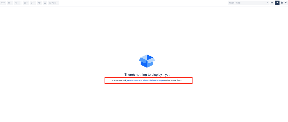

Then, the first step is to create a Program Box in the Overview module. Once it’s done, you will be redirected to the Gantt module with a link to the Scope definition.

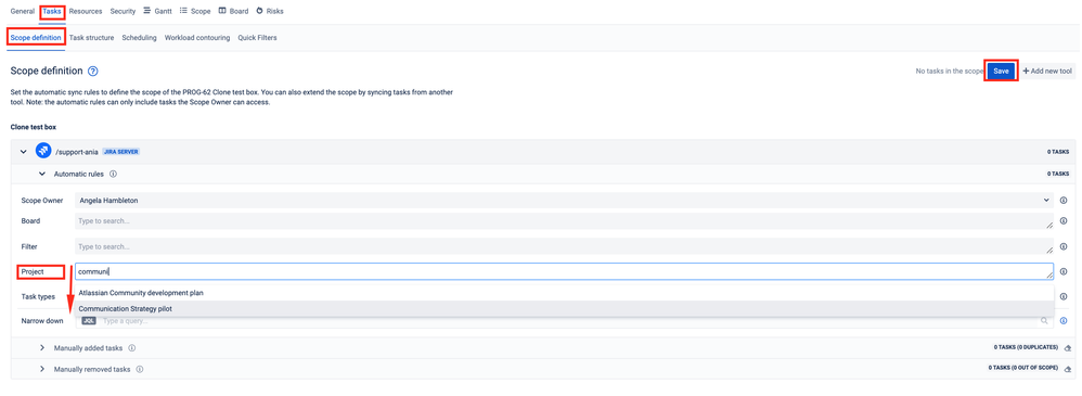

When you click on “set automatic rules to define the scope,” you will be transferred to Scope Definition. So two clicks, and you are in the place where you can define the scope of your Program. You mentioned that you would like to add the Jira Project. Please enter its name in the right field. See my image as a reference.
Anytime you want to change the scope definition by adding new Jira Projects, Boards, or Filters, please go to Box Configuration >> Tasks >> Scope definition.
Please, have a look also at our short video tutorial - How to manage Scope.
