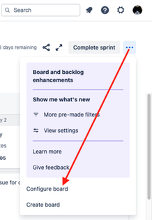

If you go into one of those sub-boards and select Configure Board...

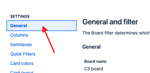

...and then click on the General option...

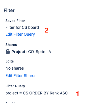

...and scroll down to the Filters section you will see the actual filter criteria (1) and the name of the saved filter (2) that was created by that operation.
If you want to change the filter to select a subset of issues from the project, then you can click on the Edit Filter Query link at (2). That will take you to the "View all issues" page showing you the filter query and the results. There you can change the filter and save the changes, and those changes will become active wherever that saved filter is used.

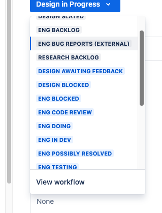

I'm not sure if this is the right approach... but here's what I did. Within each sub-board, I created my issue types to start with the name of the sub-board. For example, I have engineering and design sub-boards on this over-arching board. The issue type is assigned to the design sub-board by selecting an issue type with "design" + the name of the issue type. Then, I have that issue type provisioned to display for that sub-board only. On the over-arching board, I pull in all of the issue types from both the engineering (eng) sub-board and the design sub-board. Does that make sense? Did I do that correctly?
In regard to your second question, what I mean by "variable names in the filter" is the "project" value under Filter Query in the screenshot example you shared. I guess my question was more of an aside... When setting up filters, how do you know how to type the column name to apply a filter? Is it the column name in camel case or something else?

The screen image you provided is not a list of Issue Types. That is a list of Statuses that can be assigned to issues. Most of the available issue types for a project are displayed in the Create Issue dialog:

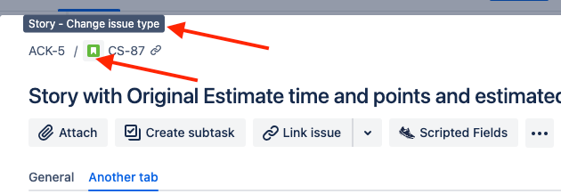

The Issue Type of the current issue you are view in your image can be seen by hovering over the issue type icon in the breadcrumbs at the top of the display.

What you have shown, as I said, are the Status values that are available for the current issue you are viewing, given its current status. Those come from the Workflow associated with that type of issue for that project.
Personally I don't think using Workflow Status values is a good way to designate the sub-board on which you want an issue to display. Do your teams actually use different workflows for their work? It makes an overly complicated workflow to have all those different statuses. And, as you can see from your list, all the statuses can be used in the current issue. Do you really want to transfer issues from one team to another by changing the status of the issue?
You could truly use Issue Types, though again, that is not what I would recommend unless your teams/sub-boards really have different types of work or need different workflow statuses for their work.
