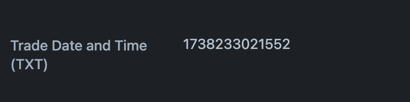

Mareli
January 30, 2025
Hello Bill,
None of these worked.
This is the result I get:
Bill Sheboy
January 30, 2025
In your question, you asked about using the milliseconds format, which is an integer number since the start of Epoch time (i.e., a UNIX timestamp).
Returning to Trudy's question: what problem are you trying to solve?  And what would be an example date / time format that would help you solve that?
Knowing those will help the community offer better suggestions.  Thank you!

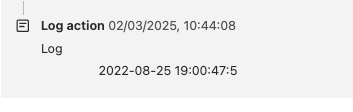

February 3, 2025
@Mareli
I just wanted to extract the milliseconds. We needed it for reporting that we needed to do.
This was my solution: {{issue.created.format("yyyy-MM-dd HH:mm:ss")}}
If you look at the documentation for smart value functions/formatting for date/time values:
https://support.atlassian.com/cloud-automation/docs/jira-smart-values-date-and-time/
...there is a reference at the bottom of the formatting table to additional formatting commands in Java documentation.
https://docs.oracle.com/javase/8/docs/api/java/time/format/DateTimeFormatter.html
According to that documentation you would use "S: to get fractions of a second.
{{issue.created.format("yyyy-MM-dd HH:mm:ss:S")}}
