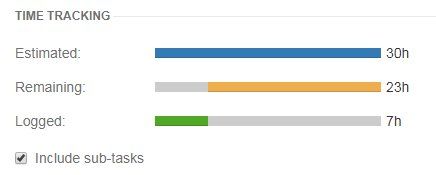

If you look at a parent issue where you know some time has been logged on one of it's subtasks, do you see something like this?

@Shawna Maas, it has been awhile since i have been scrumming in JIRA so the following may not help. I thought that if you select "include sub-tasks" under Time Tracking for the issue then the time logging was accounted for in the burndown.
