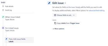

However, here's what this rule would look like (this rule should be created inside the RECRUITMENT project):
Change the link type (blocks in my example) to anything you want. Change as well the fields you want to copy, using the "copy from Trigger Issue" option.

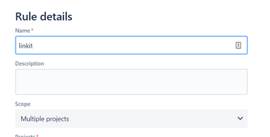

On the rule details, don't forget to change the scope to MULTIPLE projects, and then choose the two projects.
Finally, keep in mind that global rules have limitations (ready my previous comment). If my answer satisfy your question, please mark it as accepted, in order to help others inside the community.

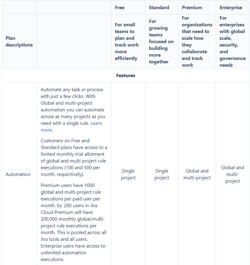

We are currently on a Standard license. I guess its not possible for that license.
Alex Koxaras -Relational-
July 30, 2021
You have 500 executions per month
