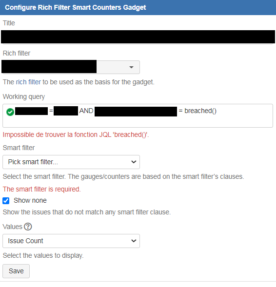

That's weird cause it's a out of the box function.
Did you put breached or breached()
Those brackets are required :)
Otherwise a screenshot to see what's going on might help!

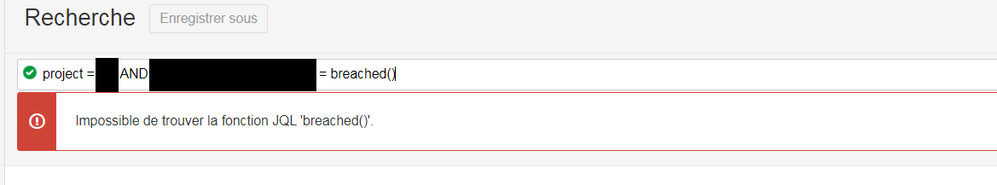

Hey @sheikh-spear
Could you try the JQL on a regular issue search (and not on the gadget)?
It seems that gadget is from an app so it could be they don't support it. If it works on a normal advanced issue search I'd suggest opening up a ticket with them on their portal

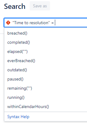

Very strange.. breached() is something that exists since a long time already.
Could you maybe do a type ahead to see what happens? (maybe the language is messing with us)
When I type my SLA's name and then the = mark I'm presented with all the options.

Hi @sheikh-spear ,
This is Gökçe From the Snapbytes team.
We recommend using the Search 3.0. for this.
For your use case slaFunction= isBreached() would do nicely.
It has functions for remainingDuration, elapsedDuration , remainingPercentage and elapsedPercentage functions you can use.
https://confluence.snapbytes.com/display/TTSToggle/SLA+Search+3.0+JQL+Functionalities
For further support, you can open a support request here: Time to SLA Customer Portal
