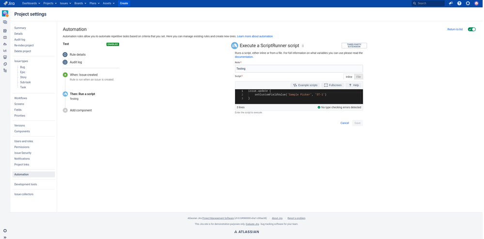

Below is a sample working code for your reference:-
issue.update {
setCustomFieldValue('Sample Picker', 'ST-1')
Please note that the sample working code above is not 100% exact to your environment. Hence, you will need to make the required modifications.
Below is a screenshot of the Automation configuration:-

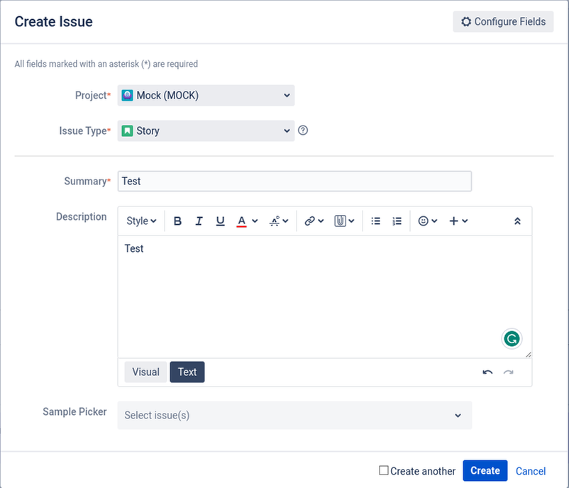

1. When the issue is being created only the Summary and Description fields are filled. The Issue Picker field is left empty as shown in the screenshot below:-

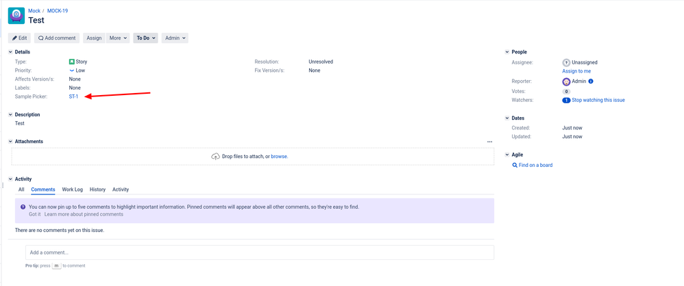

2. Once the issue is created, you will notice that the Issue Picker field is automatically updated to the value that has been set in the Automation configuration as shown in the screenshot below:-
