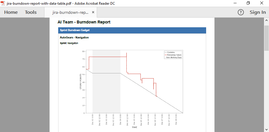

I can suggest at least two solutions with our apps.
Easy
Using the PDF View Plugin you can export the Burndown chart and the related "event table" to PDF.
And then "sprint scope" type events display what you want to see!
See this sample PDF.
jira-burndown-report-with-data-table

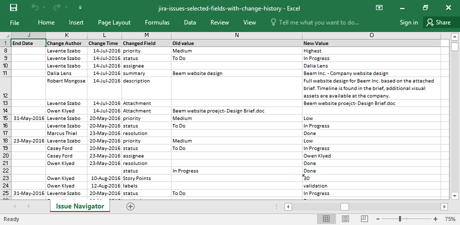

More manual, but also more flexible
  1. You run a JQL query like "sprint = Foobar" in Issue Navigator to find the issues in the sprint.
  2. Then export these issues with their complete change history to Excel using the Better Excel Plugin.
  3. Then in Excel, you filter the "changed field" column to show you the changes of the "Sprint" field and maybe filter to hide those rows where the issue was added before the sprint start, as those are not "scope change".
See this sample XLSX.
jira-issues-selected-fields-with-change-history

The first option does not allow me to manipulate the data so I believe I will drop it.
For the second offer as I understand to extract history of issues I must have the better excel plugin, correct?
Also it will provide me information only for issues that was added to the sprint and I will be missing the ones that was removed, correct?
Thank you in advanced and have a great week a head,
Idith
Aron Gombas _Midori_
February 25, 2018
Yes.
No. It will support both. From the change history point of view, both "added" and "remove" are just changes in the value of the "Sprint" field. "Added to sprint X" is when the new value of "Sprint" is "X", while "removed from sprint X" is when the old value of "Sprint" is "X".
