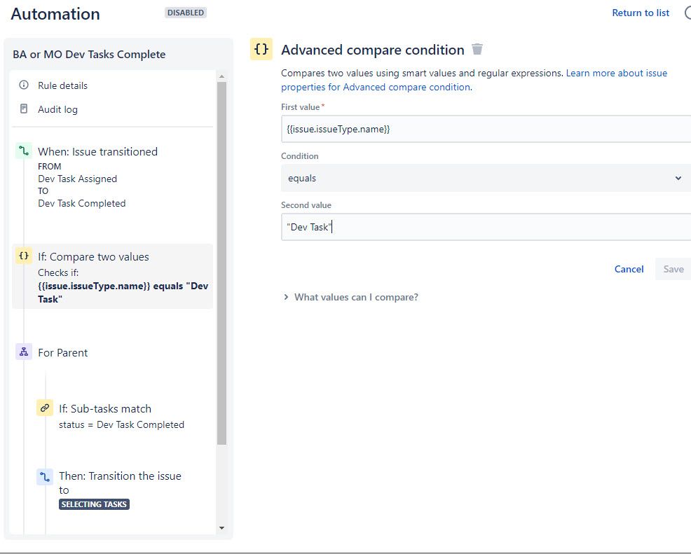

I have a rule to transition a parent issue when all the sub-tasks are completed.  It works with one sub-task/Issue Type/workflow: {{issue.issueType.name}} equals "Dev Task".

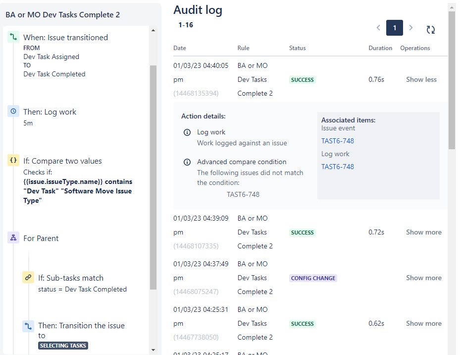

I created a second sub-task Issue Type, but when I tried to add it to the compare using {{issue.issueType.name}} equals "Dev Task" "Software Move Issue Type", the automation log shows: "The following issues did not match the condition:" and the sub-task issue key.

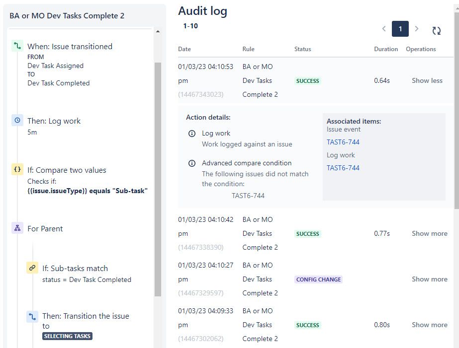

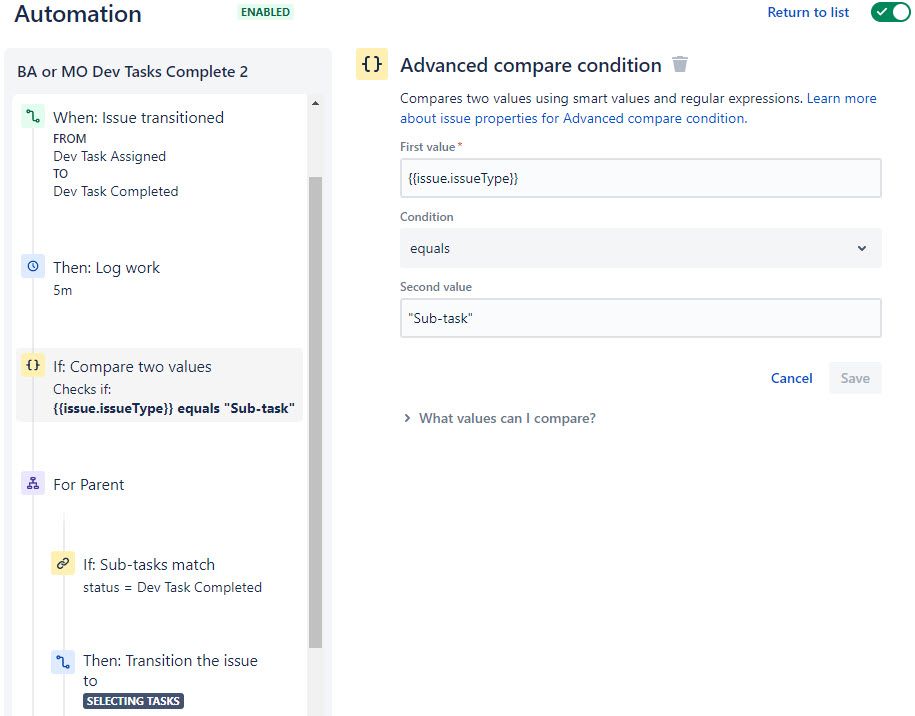

I changed the first Compare to {{issue.issueType}} and Sub-task, but it apparently isn't working.  Since there are two issue types, if I go back to {{issue.issueType.name, I don't know whether or how the rule can be changed so that it looks at both.

1) Original rule that worked when there was one sub-task issue type (one workflow):

3) New rule log, showing success only because of comment written to log:
Note that the same Advanced compare condition that did not work appears for both sub-tasks, that use different Issue Types and workflows but share the same statuses.  I also get the same result if I don't use quotes around 'Sub-task'.

3) Log for rule with {{issue.issueType.name}} and both issue type names:
