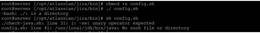

I was not able to execute config.sh on CentOs 6
I have JIRA running insecure on http://myserver.com
I am trying to change it to https://myserver.com
I stopped the jira service and tried to run config.sh
config.sh* does exist in the /opt/atlassian/jira/bin directory referenced below
What am I missing?
Jira is running, so that means it is finding JAVA right?
I am not sure if I need to point to something with environment variable
Looks like the default environment file is empty
root@server [/etc]# cat environment
root@server [/etc]#

I had the same problem. In my case it showed:
"./config.sh: line 41: /usr/bin/java/bin/java: Not a directory"
And I found a workaround.
Go to config.sh and find line with '_RUNJAVA="$JRE_HOME"/bin/java'
I deleted /bin/java and left there just "_RUNJAVA="$JRE_HOME"
If this doesnt work for you, maybe you have to direct it to valid java(or jdk) directory.

Hi @Shirley Shorter
There shouldn't be any space after dot  slash - ./config.sh
Try to run it again.
Ravi
Shirley Shorter
June 10, 2019
No, same result if I run root@server [/opt/atlassian/jira/bin]# ./config.sh
./check-java.sh: line 31: [: -ne: unary operator expected
./config.sh: line 41: /usr/local/jdk/bin/java: No such file or directory
