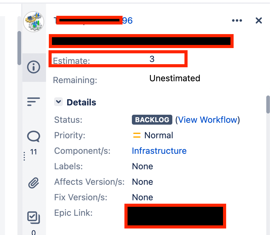

Hi all,
I created a new custom issue type. In the scrum board, all the existing issue types have the filed "Estimate", but not the custom one. Do you know where is the configuration to enable this?

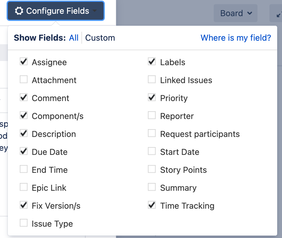

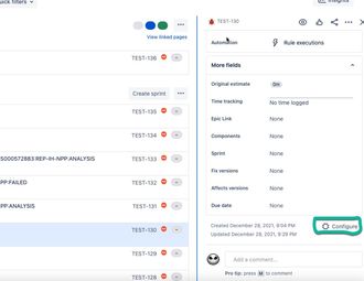

Can you go to your backlog, find a Maintenance issue and select it. on the right sidebar if OE is not displayed then click Configure as shown below.
in the next screen see if you find OE anywhere. Maybe a hidden field? If it is no where to be found then it is not hey in your screen scheme I think.

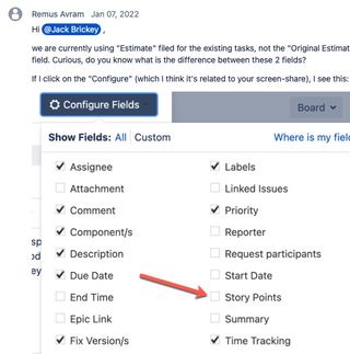

Hi @Jack Brickey ,
we are currently using "Estimate" filed for the existing tasks, not the "Original Estimate" field. Curious, do you know what is the difference between these 2 fields?
If I click on the "Configure" (which I think it's related to your screen-share), I see this:
Even if I have all selected, I still don't have the "Estimate" filed in the scrum board.

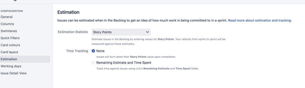

This is the scrum conf for the story points:

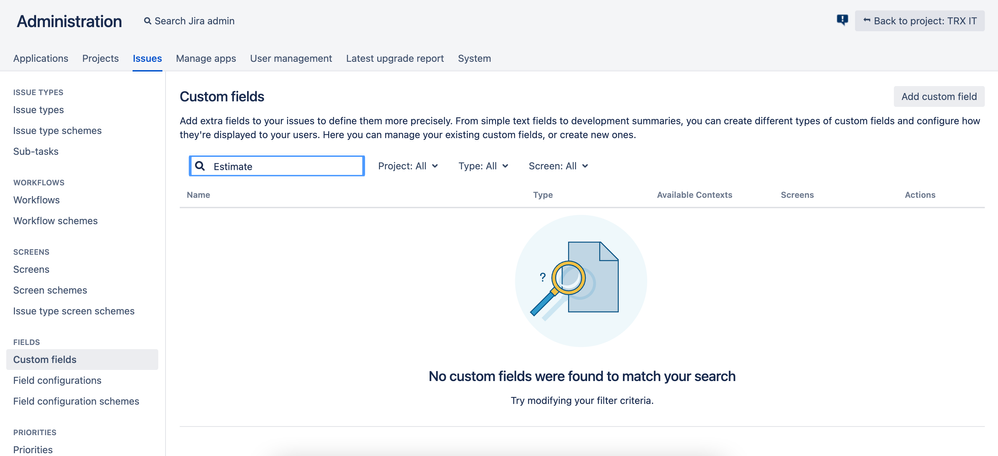

Jack Brickey
January 7, 2022
First, I suspect that someone has created a custom field called "Estimate". If you are using Story Points for estimation, as illustrated in your boards Estimation view, then you should have "Story Points" as the field where you place your estimate. To confirm go to admin>issues>custom fields and search for Estimate. If this is the case I think you need to find out why that is being done and understand that it likely is unwise. Now maybe things have changed in later version and what you see is simply different than what I am experienced with. BTW, I also note you have Time Tracking off so assume you will not be using that feature.
As an FYI, Regarding Original Estimate, that is used if you are using Time estimation vs. Story Points.
Note in the second image where you show Configure Fields, you can click "where is my field?" and it will guide you a bit.

It doesn't looks like "Estimate" is a custom filed

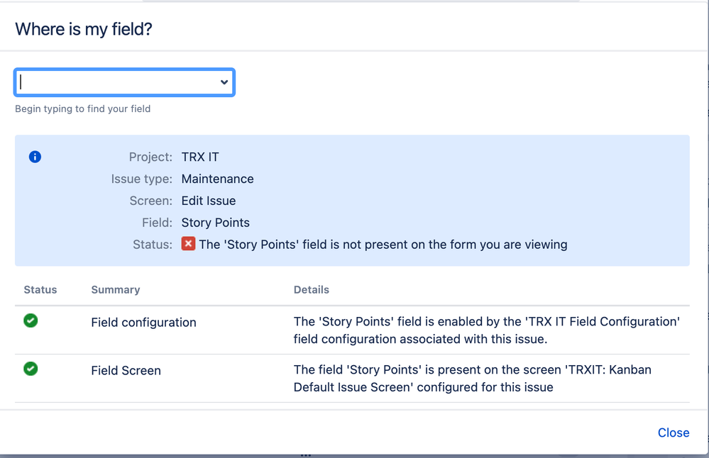

When I click "where is my field?", I get this message:
Remus Avram
January 7, 2022
"The 'Story Points' field is not present on the form you are viewing"  - how can I add this "form" to add the 'Story Points' to it?

Jack Brickey
January 10, 2022
in the image you posted on Jan 7 above w/ all of the checkboxes you can check "Story points"...

Hi @Jack Brickey ,
as I mentioned in my previous post, "Story Points" is missing from the "Maintenance" issue type. When I click "where is my field?", I get "The 'Story Points' field is not present on the form you are viewing"  - how can I add this "form" to add the 'Story Points' to it?

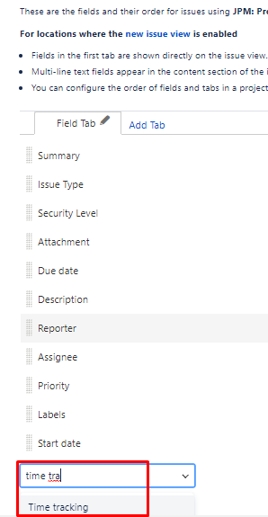

You have to add Field called "Time Tracking" to the screens(create,edit,view) of the newly created issue type. Then you can see "Estimate" and "Remaining Estimate" fields on the tickets.

Vishwas
January 7, 2022
Hey @Remus Avram
No issues, let me guide you.

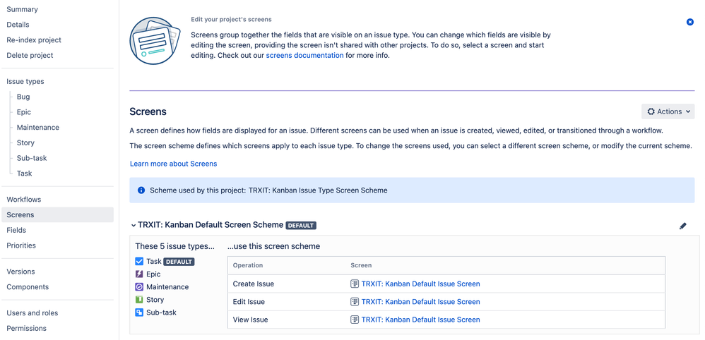

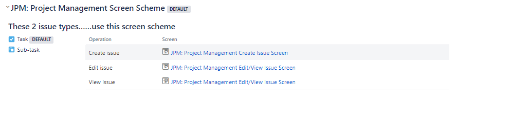

Navigate to Project Settings --> Screens there you will see "Screen Scheme"
like this
Then click on the screen like "Create issue", "Edit issue", "View Screen" and field like this
Hope this helps !!

January 7, 2022
Thank you @Vishwas  for guiding me. The "Time tracking" is already there.
The "Estimate" filed is showing for all the default issue types, but not the new created one.

January 7, 2022
Hi @Vishwas , we have the same fields for the "Task" issue type as the "Maintenance" issue type. However, the "Estimate" filed in the scrum board is missing for the "Maintenance" issue type.

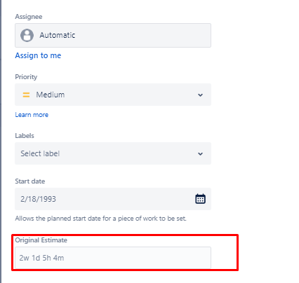

Hey @Remus Avram
Can you try editing the newly created issues and add value for "Original Estimate" field ?
So then it should appear as Estimate value.
