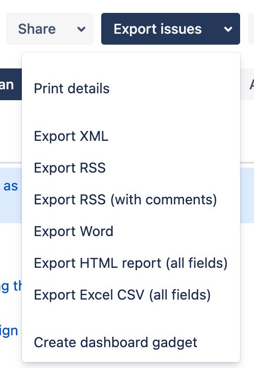

I exported the tickets from the issues board.  It doesn't allow me to do an account id mapping.  Where would I do that? This is what I see. I'm selecting "export excel csv".
There are no subsequent options offered when I do.

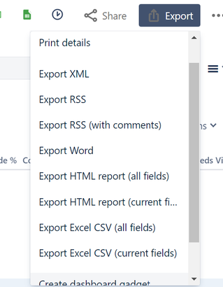

Are you doing that from the filter? Or from the dashboard? You should do it from the Filter itself.
This is what I see - curious that you don't have the same options.
I use the Export Excel CSV (current fields) and it always includes the account ID of all user fields, if I want them or not.
