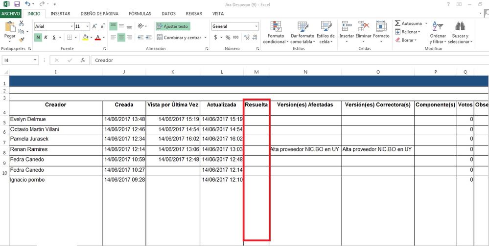

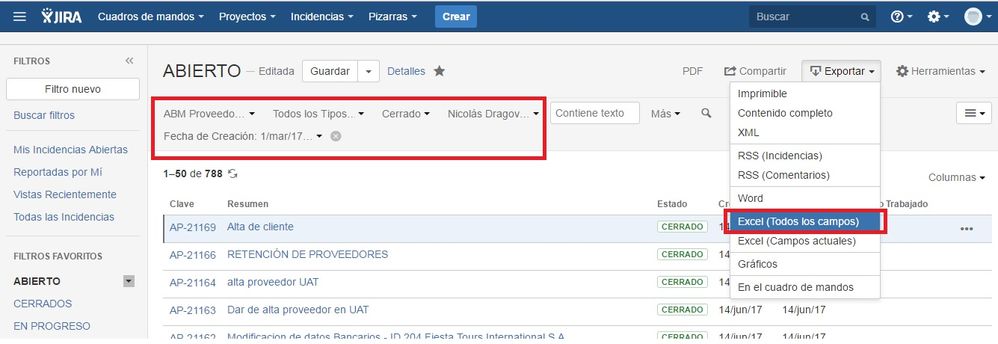

The resolution date doesn´t show, when I download a report from Jira,
I attach the way I download it and an example of the report where it doesn´t show the resolution date.

But I don´t have the resolution date.
When I download the report, I need to see the Resolution date.
As you can see on the print I´ ve attached, the resolution date is empty.

Go to under columns and search for the field "Resolution Date". I dont believe there will be any field/column because there is no system field called Rresolution Date". As a solution, you can add a custom field as "Resolution Date".

As per the print you attached, the "Resolution" field is not the "Date" field type. It is a Tesxt field type and it is not Custom field, that's the system field which you can't modify and it is controled by the workflow "Post-Function".
As a workaround you can create your own custom field with the name "Resolution Date" with "Daate " and add the field to all the screen's (Edit & View). You will be good to go.
