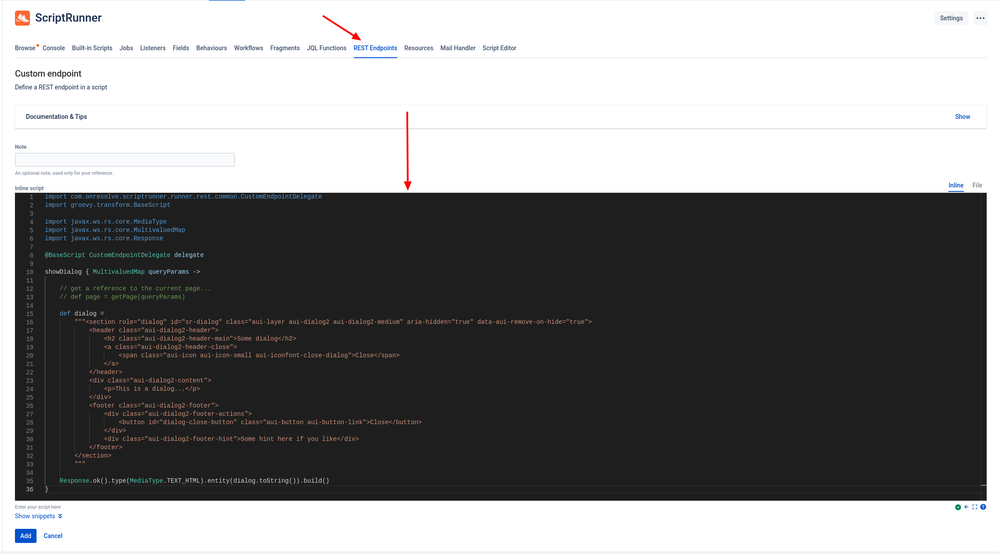

Below is a screenshot of the REST Endpoint configuration:-

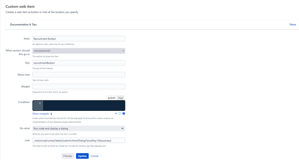

You mean I don't have to add js like inline script? But where can I add it in Fragments? There is no any place where I can add it
111.pngThe condition is empty so that everything is included in the picture
Previously JS script was added in showDialog rest endpoint

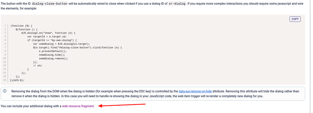

If you read through the ScriptRunner Web Item documentation carefully, you will notice that it provides a link for the Web Resources Fragment as shown in the image below:-
This link points you to the ScriptRunner Web Resources documentation which explains how you need to setup the custom directory to add the javascript.
You only need to use javascript if you want to make a more complex request. Else, the invocation to the REST Endpoint should be enough.
