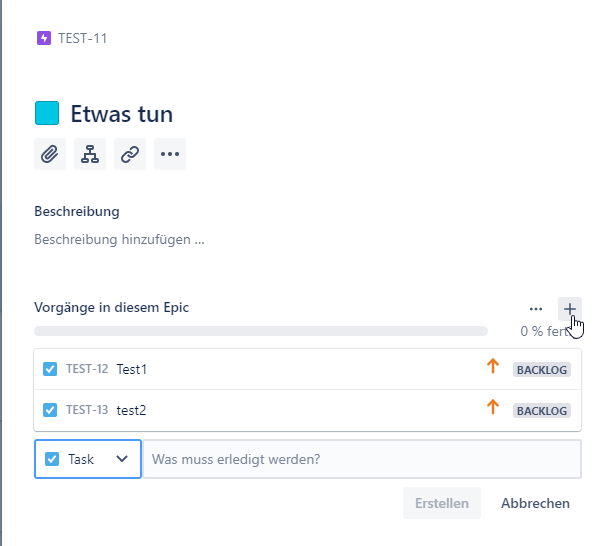

Hi there,
starting with Jira poses a looooooooot of questions.
So my question is:
While looking at an epic, you're able to create subtasks. So far so good. But our epics require components, so do their subtasks. But the mask doesnt allow adding a component to a new subtask. The only chance to achieve this is
a) either stop making components mandatory
b) create an issue and use the "epic link" field
non of this is satisfaying. Cant I add a second field to this dialog? thxepic_view.png

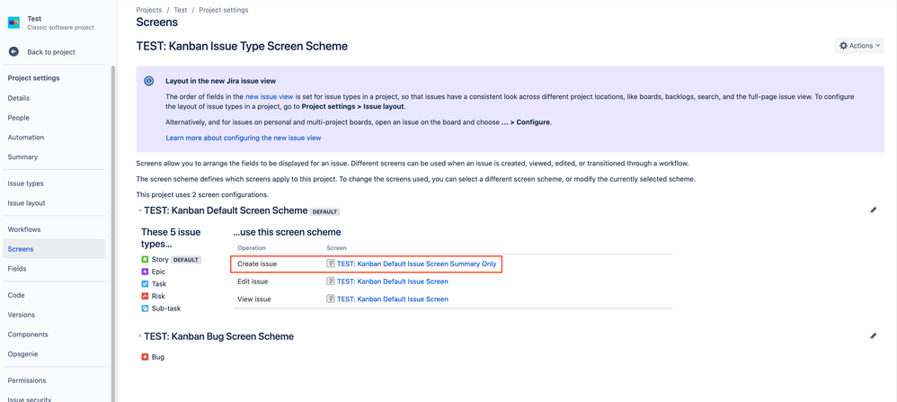

Hi @Markus Günther, thank you very much for raising this issue. My name is Matt, I'm a product manager on Jira Cloud and my team has just had a look into this one for you.
After a bit of digging we were able to reproduce this. We believe the problem arrises because the required field is not on the "Create" screen for this issue type.
You can fix this by going to Project Settings -> Screens and dropping down the screen configuration for the issue type in question. You will then want to confirm that the "Create" screen that is selected has the required field on it. See screenshot below that points this out.
You can either add the required field to this screen, or if you'd like you can create a new screen that has all of the required fields and link this new screen to the "Create Issue" operation.
Let me know if this helps.
