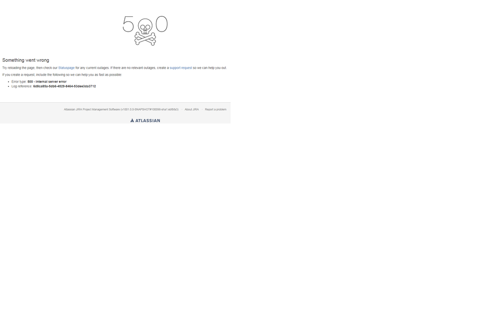

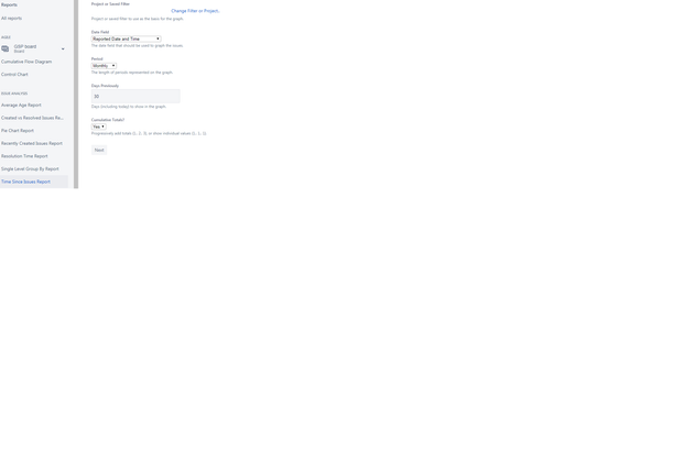

Sapna Sharma February 12, 2019
I have been facing Problem,while using filter for Reported Date and Time and In Reports of Time since Issue Reports  as Shown Below error is showing Help me on this error.jira b.png
Nic Brough -Adaptavist-
February 13, 2019
I'm afraid this is just a front-end report of something going badly wrong on the back end.  You'll need to read the application log (<jira home>/logs/atlassian-jira.log) to see what the underlying error is.
