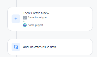

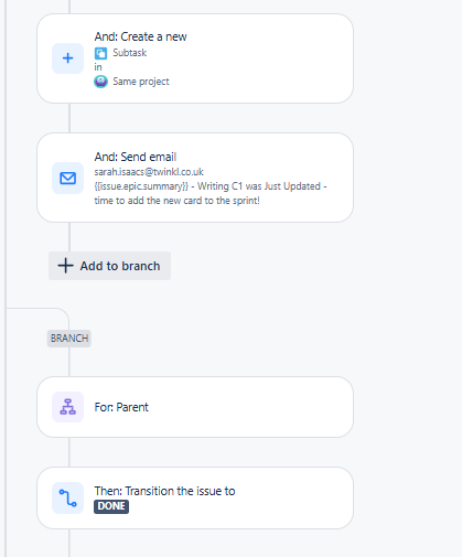

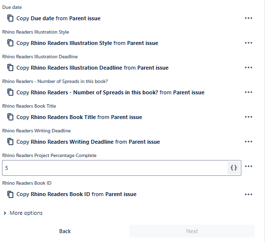

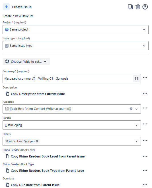

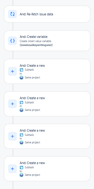

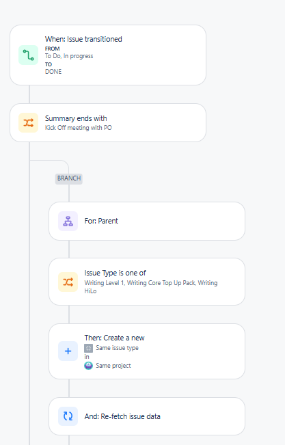

Hi,
I'm using Jira Cloud Team managed project. I only have admin for my project and not global admin. This makes for a complicated board full of workarounds.
I have created an automation that creates a task and sub task once the first task (original task has been completed (done). See Images below. I'd like to add to this automation to only create the task (and its sub tasks) if it doesn't already exist. Is that possible please? Can you help?

Hello @Sarah Isaacs
I have a few questions.
1. The rule is triggered by a transition to Done. Then it checks the Summary of the trigger issue. Then it branches to the trigger issue's Parent. What type of issue will match the trigger and Summary condition; a subtask, a standard (level 0) issue, or an Epic?
In the Parent branch when you create the new issue, in the new issue's Summary field you are referencing the smart value {{issue.epic.summary}}. That would imply that your trigger issue was a subtask, and the branch is to its parent which is a level 0/standard issue type. Is that correct?
2. Assuming that is correct, the purpose of the branch is to create a child issue in the subtask's parent's Epic. Is that correct?
Assuming that is correct I recommend that you insert a Lookup Issue action to see if an issue exists that matches the criteria of having the same Summary as the new issue you would create and is a child of the Epic.
Then check if the results of that Lookup is no issues being found.
If no issues are found the rule will proceed into the branch and create the issue.
Let me know if you need a more detailed explanation.

Hey Trudy,
Thanks for the reply, I super appreciate it.  I just wanted to thank you as this worked a treat.  I had to use this instead: {{smart values}} condition. As I didn't have Advanced Compare. You may have meant that. Thank you
Q1 he rule is triggered by a transition to Done. Then it checks the Summary of the trigger issue. Then it branches to the trigger issue's Parent. What type of issue will match the trigger and Summary condition; a subtask, a standard (level 0) issue, or an Epic? - Answer: a Sub task will contain/match the summary and trigger the branch. So yes correct.
Q2. Assuming that is correct, the purpose of the branch is to create a child issue in the subtask's parent's Epic. Is that correct? - Answer: Yes the branch is so that I can create a task and then sub tasks within the same Epic. The Epic is effectively a Book, so contains all the information - who is working on the book, the title, the type of book and then I populate the tasks and sub tasks with that information every time so that it is copied from one to another.

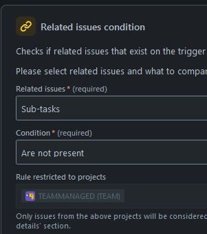

Hi @Sarah Isaacs
Can you add this check after the issue type condition?
2025-01-03 10_28_12-Rule builder - Automation - TEAMMANAGED - Jira — Mozilla Firefox.jpg
This should check if a sub-task exists. If it does, then continue with the next actions.
Regards
