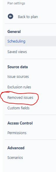

I'll try to explain me better:
On the right of the name of plan there is a "..." if you move tre cursor on it yo can seed a label "Plan settings" if you click on it appear a menu:
If you click on "Configure" you can see on the left this:
Here I find all "Object" that I remove from my Plan.
I need to know if it is possible to exclude this list from the query.

Hi @Tiziano Viglongo
The Removed Issues is an internal feature of Advanced Roadmap and it is not exposed externally, so it cannot be identified or accessed outside the plan. This means there is no way to filter the removed issues in a JQL query.
I hope this answered your question.

Thank you for your reply, sincerely hoped to get a different answer, so that you can solve my problem with the query. But if that's not possible ... I'll try to find another way (eg remove tickets from "Removed Issues" as long as this solution works). For the moment I will not accept your answer hoping that someone else can give me a workaround on my problem.
