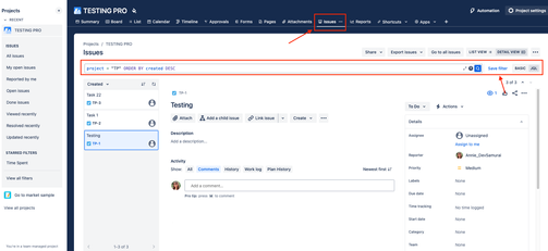

Creating custom Quick Filters in Jira Work Management (JWM) is a bit different from Jira Software. Unfortunately, JWM doesn’t currently allow you to create or customize Quick Filters directly like you can in Jira Software.
However, there’s a workaround you can try:
  1. Choose your project.
  2. Click on "Issues" in the navigation.
  3. Use the advanced search with custom JQL to create a filter based on your custom fields.
  4. Save the filter, and you can use this saved view whenever you need it.
I hope this may help.

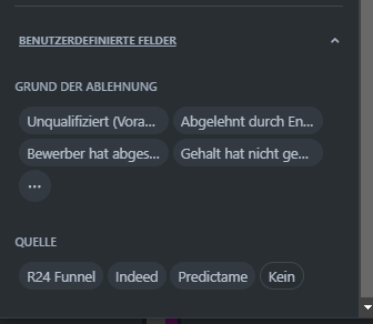

Hi Annie@DevSamurai ,
thank you for your answer.
Really appreciate this workaround. However, I am missing the Board-View here.
Do you have an idea, how Jira decides, which custom fields are shown in this "Filter" in the Board-view? It only shows me these 2, although I have many other custom fields in this project.

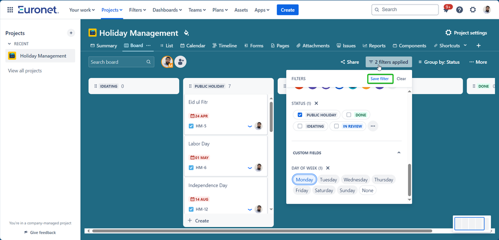

Hi,
Go to the board and filter the issues by using the given options then you can view the save filter option and save the filter.
PFA

With your method, I can only create custom filters based on the aspects, Jira shows me. The challenge is, that Jira does not show me the custom fields I need for my filter.
It only shows me these 2:
How can I add other custom fields here?
Muhammad Moazzam Hassan
August 22, 2024
Yes,
You are right there is no other custom field available. Looks ridiculous.
