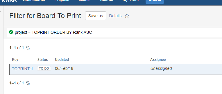

They will definitely show up if all is right. If the filter shows the issues then the board should. Are you cresting a new board after the project has been completed. Can you share your filter here?
Thanks for the time to answer, here is the detailed explanation. The filter is shown in the picture below...

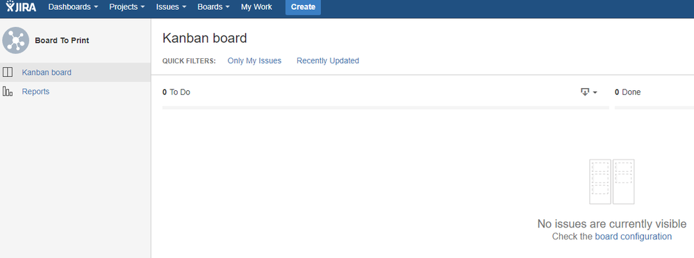

No board is created for it by default.I create a board "Board from an existing project", I select my project.

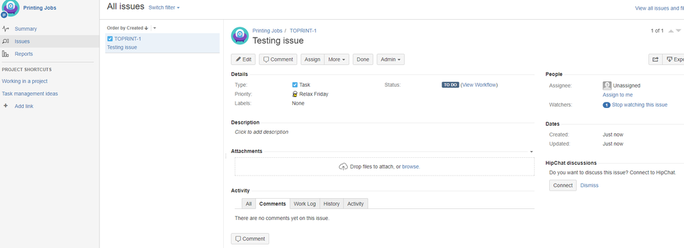

I Create a testing issue
Board is still empty
I go to Board Settings, select the Filter for the board
Go back to board, still don't see it... Even though in the filter is shown...

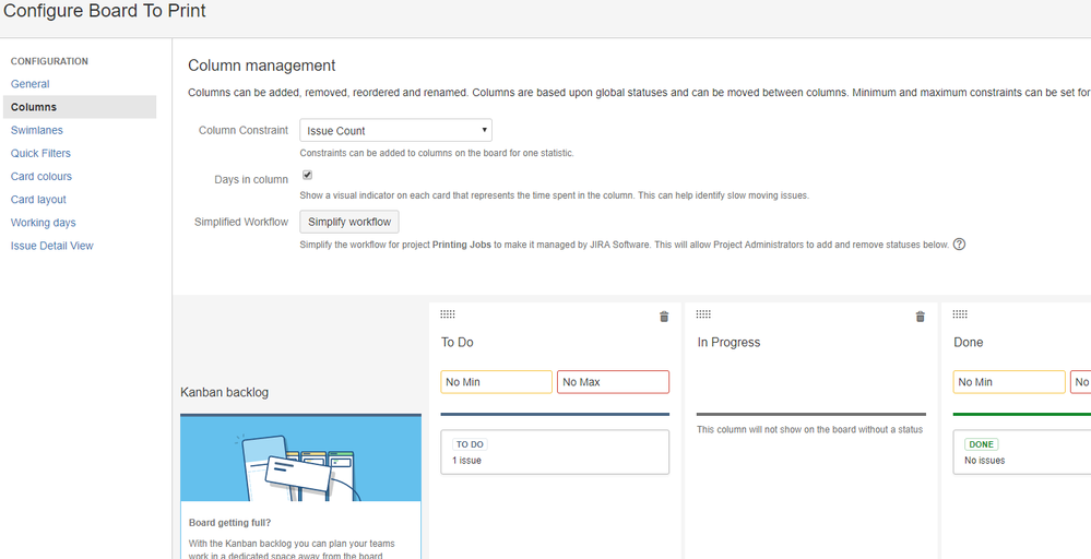

I check for Unmapped Statuses, nothing. But in the configuration I see "1 issue" in the TO DO.
Back to board, Nothing again...
I got to Swimlanes and put no Swimlanes just in case...
Nothing on the board still...

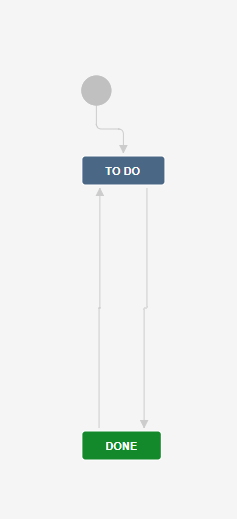

Project settings, workflow seems to be according to the board statuses...

This is the board now...
