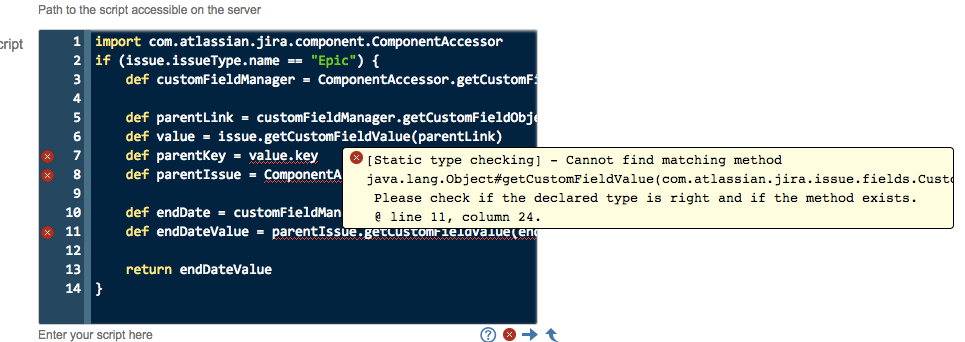

Joshua, thank you for the quick response!! I'm getting a few errors when I try to put in that code.. Can you let me know what you think? Am I missing a declaration? I'm on Jira 7.3Screen Shot 2017-08-16 at 12.31.12 PM.pngScreen Shot 2017-08-16 at 12.30.46 PM.png

The static type checker for ScriptRunner can be wrong. Sometimes, it will tell you a matching method cannot be found even if it does exist. I think that's happening here. Try to just ignore the errors, save the script field, and go visit an Epic issue to see if anything is being displayed for the field.
