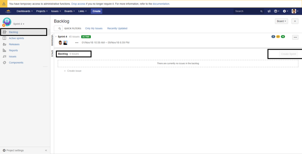

I am currently facing 2 issues:
  1. I can see the "CREATE SPRINT" Button in the Backlog but cannot click on it. Hence I am unable to create a Future SprintCreate_new_Sprint.png

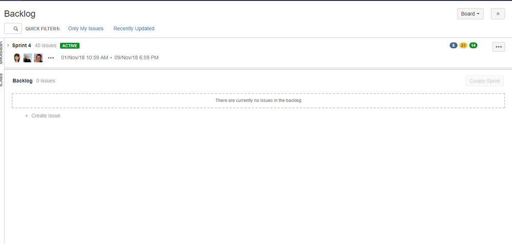

  2. I also cannot see any issues in the backlog from the backlog view although I can confirm that there are issues in the backlog as I can view them when I run a JQL filter. Why can't I see them in the Backlog view itself. Refer to attachment please.
I would really appreciate any assistance and input!

1. Yes, I am the permission to manage sprints as my project role is that of an Administrator. Infact I had been managing all the sprints and backlog until the backlog of issues and future sprints just "disappeared from the backlog view".
2. Parallel Sprint is not enabled. However I do not want to run a parallel sprint. I want to create a Sprint for the future without Starting it. E.g. Sprint 4 is our active Sprint. In the past I was able to create a future Sprint e.g. Sprint 5 which I would start when the active sprint ended.
3. The filter of the active sprint's board is fine. Is there a way to check the filter for the backlog?
My main issue is that the Backlog is shown as Empty when I am on the Backlog view and the Create Sprint button is also blurred out.Please see image below.
Kind regards,
