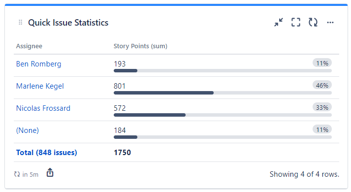

I am Marlene, product manager of Quick Filters for Jira Dashboards.
With our marketplace app, you can build advanced Jira dashboards and also aggregate values from any Jira number field. It is possible to show the sum, minimum or maximum values or average values.
These features can help you with these use cases.
  • Target vs Actual Story Points Completion
  • Story Points "picked up" vs Completed per Assignee per Sprint (Shown by percentage)
I would recommend to build the statistic with the Quick Issue Statistics gadget, and then add a filter to the Quick Controller gadget to filter it per assignee and sprint.
You could also work with the Two Dimensional Filter Statistics gadget, use Story Points as the values to shown and the Assignee and Sprint as dimensions.
