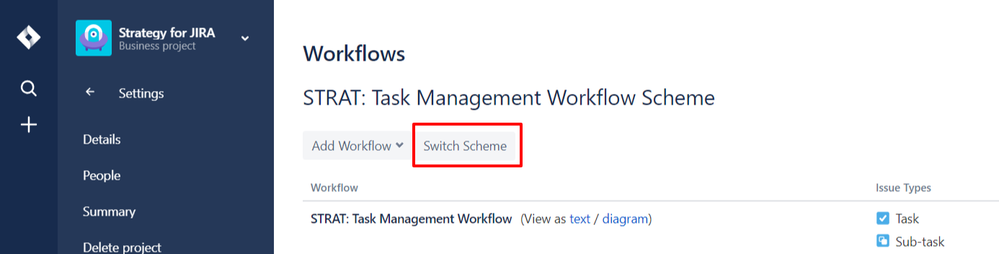

Hi @Marc-André Goderre, Your terminology isn't familiar to me, so it's possible my terminology may not be familiar to you. I'll try to answer your question anyway. :)
In order to change the Workflow your Jira Project is associated to, you'll need to be a Jira administrator, or a project administrator if your project has a unique workflow and that ability has been turned on.
If either of the above are true, you can see the Workflow your project is using from it's admin page.
In Cloud: From inside the project, click the Settings ("gear" icon) link on the left sidebar and then click "Workflows" link. That will take you to a URL like: https://YOUR-JIRA-LOCATION.atlassian.net/plugins/servlet/project-config/YOURPROJECTKEY/workflows
From that page, click the "Switch Scheme" button to change the Workflow Scheme for the project to another existing scheme. See screenshot.
Hope that helps!
