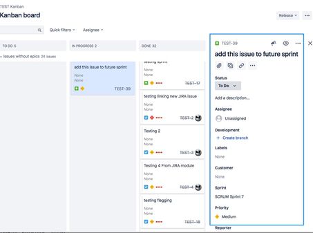

I think you're right. The view screen. I can't see how to configure the view screen. Any ideas? It's not in the board config
Jack Brickey
August 20, 2018
You cannot configure the ordering of issue detail screen as shown below. as Nic mentioned if the fields are removed from the view screen they should disappear from the "issue detail" view.
