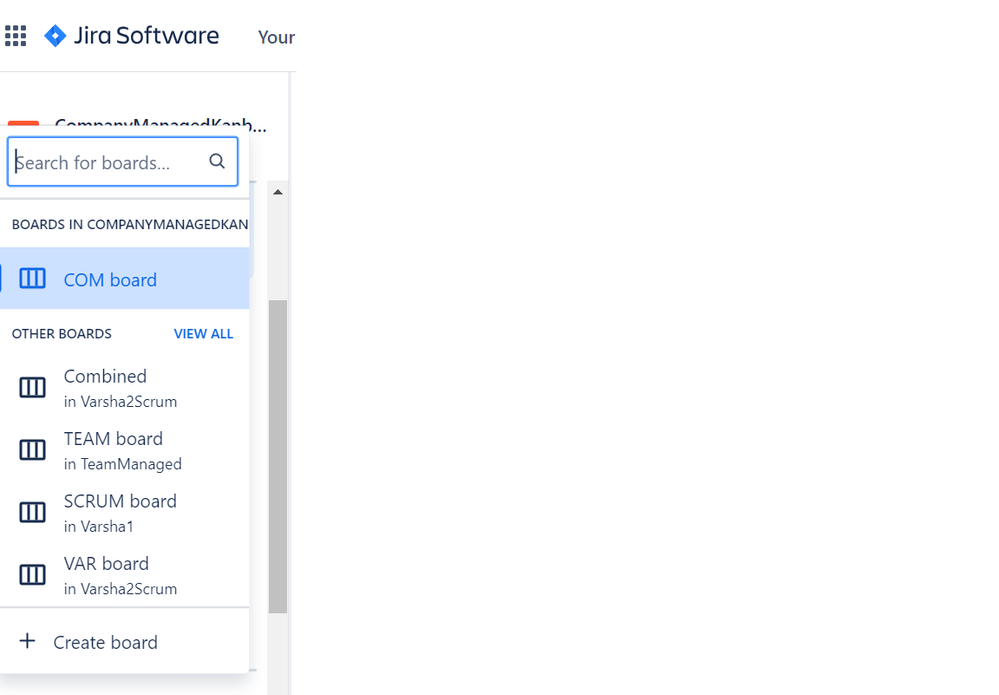

Jira.pngHi For team managed project we can have only one board, This could be challenging.
For a company managed project we may add multiple boards, adding Kanban or scrum boards will be easy as it is only organization of issues in  or across a project. Here select an existing board, Create board , select scrum or Kanban and using a filter set up a new board.
