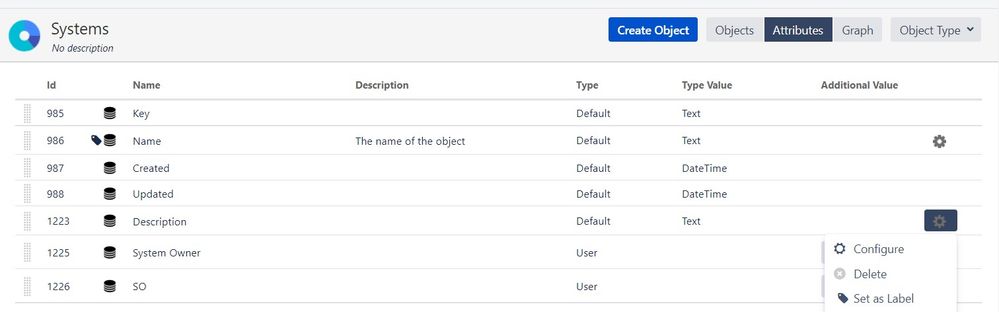

You can use Text type attribute for setting as label.
You can click settings button of atribute and set as Label.
If you need to change atributes on issue view, you should to go to settings of customfield and edit insight configuration. See issue view. If type of atribute is another object it show him Lebel on issue view.

Hi Pavel,
Thank u. But set as label is available on some types not all of them. Actually, I prefer when u add an attribute on 'Object attributes on Issue view', just these fields appear on Issues. But it firstly catches label attribute and than adds others on buttom side. When I do not want to use Label on Issues view, it is obligatory, I think.
