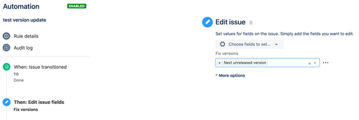

You can achieve this goal using the Jira Automation functionality. These would be the steps:
  1. Navigate to your Project > Project settings > Automation
  2. Create the following rule, replacing the status "Done" to "Close" (I only had the status "Done" in my test instance):
The rule above will add the version that is in the bottom position of the release page of the project, which is the oldest unreleased version by default. It will not consider the version start or release dates.

Thank you for pointing out my mistake. Indeed, I have uploaded the wrong screenshot in my last reply.
I edited it with the correct one now. Please, let me know if that automation works as you need.
