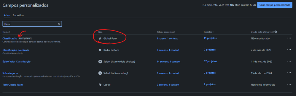

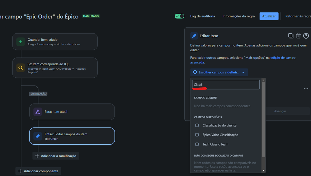

Thank you for the advice. I'm not entirely sure if I understood everything correctly, but what I need to do is copy the "Lexorank" field of the Global Rank to another alphanumeric custom field and replicate it for all Stories within an Epic. However, I'm having trouble finding a way to copy the data from the Rank field.
That's the field.
I can see it in the "Issues" screen.

where in Automation are you looking for the field?
Guilherme Bombonato Vaz de Mello
April 25, 2024
Hello! Thanks for your reply.

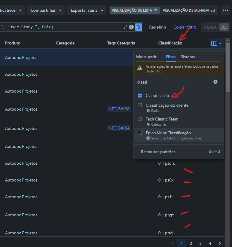

I'm trying to find this field called "Classification", that is our Global Rank field
On the "Issues" screen, I'm able to find the field and see the data
