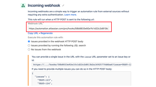

For example, first create your webhook trigger. You see the provided url like so:

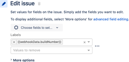

Now, your build number is accessible via smart values in subsequent components in your rule, as {{webhookData.buildNumber}}. If you wanted to add this as a label to your associated issue, TEST-1, you could add an 'Edit Issue' action like so:
Note: In edit issue, select 'Choose fields to set...' as 'Labels', and then you can choose to add instead of replace labels by selecting the '...' option on the right hand side.
