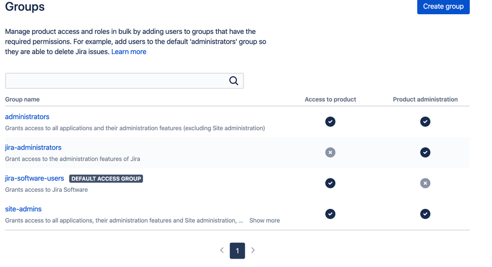

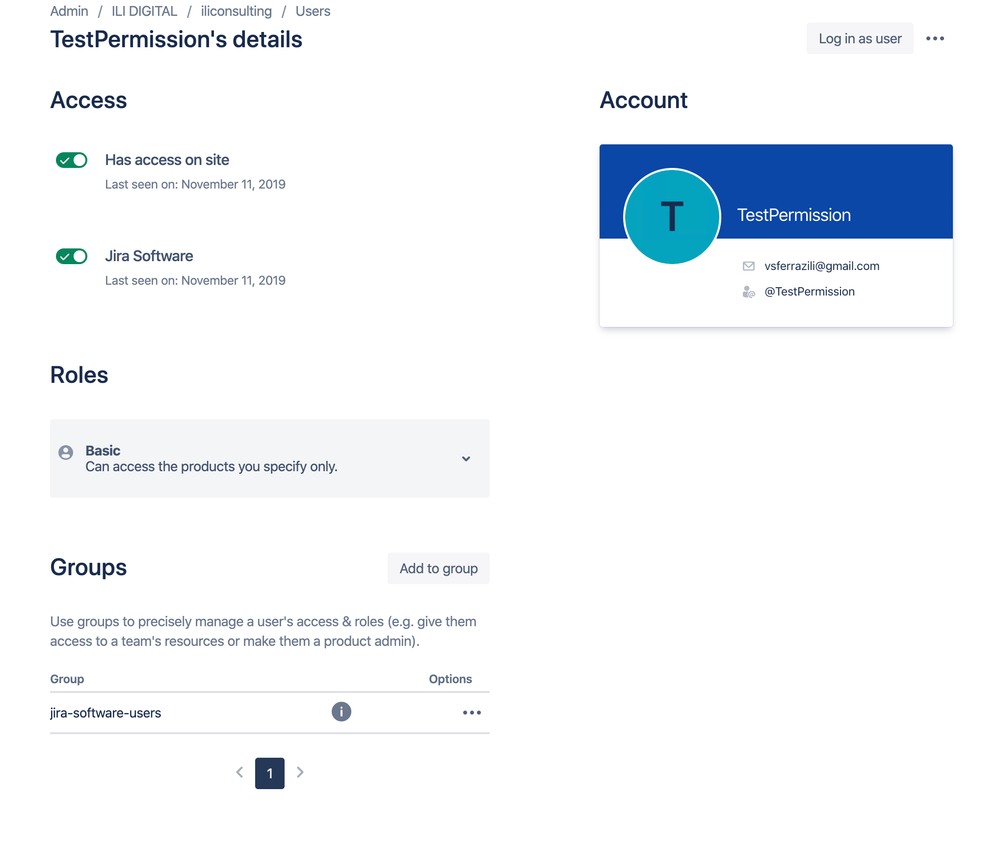

This is how it is setup in the admin page, maybe it is something to do with that?
Yes, you will need to modify the other existing Permission Schemes to use a different project role for Browse Projects that does not include the External people.
It's a bit of extra work, but it will function as you would like it to.
I created a new project role under system > security, I added this role in the project in question, I changed the permissions and I added that role to the project in question as well. The user can still see the other projects.

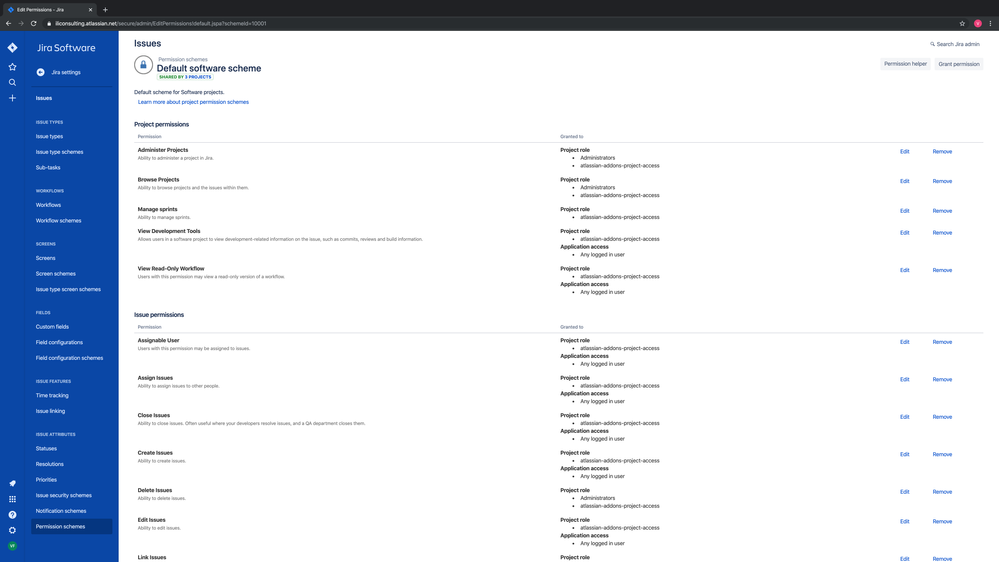

Yes, that will work, but you need some mechanism for your internal users to see the existing projects as well. Just check your permission scheme for Browse projects for those. If you can post a screenshot of the Browse Project portion of one of your permission schemes, that would be helpful for guidance.
For your other screenshot above, no that's not the Permission Scheme, that's just the list of Groups available in the User Administration area.
For the Permission Scheme, go to Project Settings > Permissions.
You are right, now I (and colleagues) cant see the other projects' content. That is how it is currently:
So what I did, in the system management I created a group like "full-project-access" and only added internal people, then I added this group to the permissions, it seems to be working :)
Yes, so one way to go about this is to create another Group under User Administration, and place all of the non-External Users in this new group. Then add that Group to the Permission Scheme for each item.
OR you can grant a project Role such as Users to the Permission Scheme for each permission and then place the new Group in the Users project role.
I would probably do the second one. But then as you create each new project, you will have to remember to add them to the project role, even if you copy the project from an existing project.
